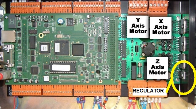

The control voltage is created by a regulator on the right hand edge of the card. There are 3 15 pin L298 stepper driver chips next to it.
The Regulator will shutdown if it goes over current or over temperature. I would also look at the regulator and see if its screwed tight to the heatsink.

There must be a fault on the control card dragging down the supply. You may need a new card.
Where are you located?
You could remove the top card with the seven seg display. Power on and monitor the voltage. This would at least identify if the top or bottom is the fault.

With the top board removed I get the 5v still. But I get a drop to +/-0.1v on the others.
Re: Novamill will not connect - limit switch error
It sounds like the top card is the problem though as we have removed most the load from the board it still does not rule out the bottom card having a fault.
The top card can be replaced with a USB card.
The part number is BI00434YY a complete card is a BI00435C
