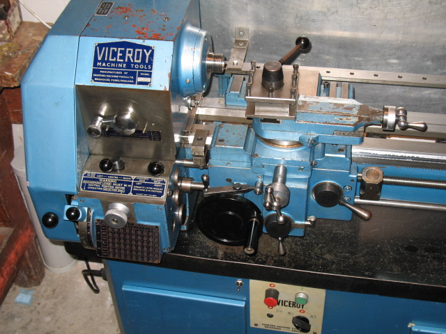

saddle feed stop
Could you post some pictures of the saddle stop? I can't picture how it works, but I'd like to make one for my own TDS1. Your story & series of rebuild pics has inspired me to get on with cleaning it up; I bought it in january last year but other than putting it in the shed and wiring it up, it has been neglected. :oops:
Cheers,
David
I have posted an extra photo in the Apron Reassemble posts. The lead screw handle disengaging bar extends from the tailstock end right across the saddle to the headstock side. Image 204 is right-way up with the bar removed. The machined flat on the top edge is where the bar sits. It fits in a gap between the apron and the bed. A stop is clamped to the bed where required.
The right end of the bar is Z shaped with a rack gear. This engages with the gear teeth on the handle. See image 192 to see all the parts. The bar is at the very bottom of the picture.
When the bar hits the stop, the right end of the bar rotates the lead screw handle as the apron moves toward the headstock. The limit adjustment pin sets the limits of the bar travel. When the handle rotates, it spreads the half nuts. It should only take about 6mm travel to disengage the half nuts after hitting the stop.
It's quite tricky to set up. It only works in one direction which is fine if you don't cut left hand threads.

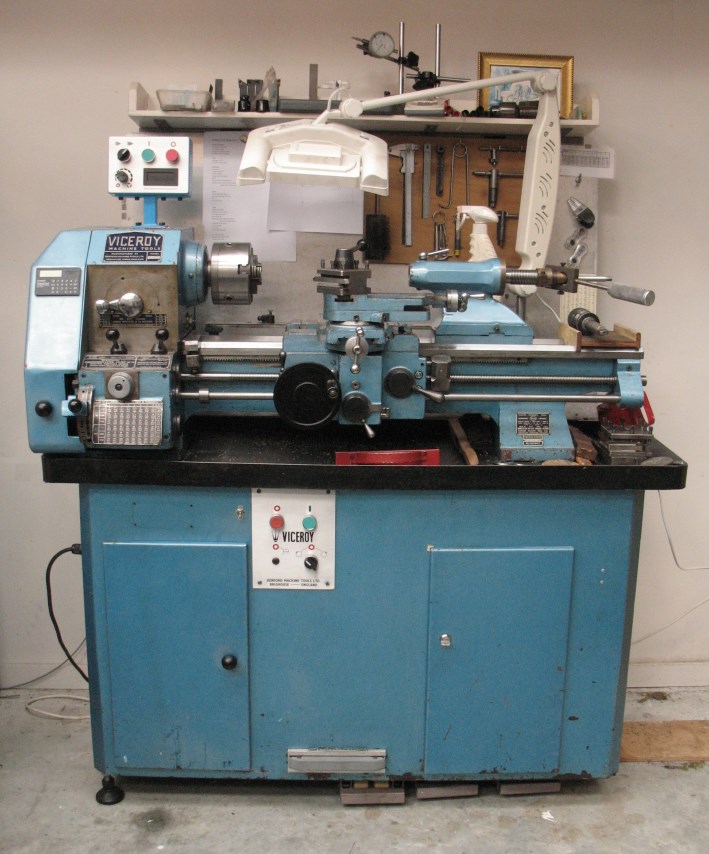

Re: Viceroy T.D.S 1/1 G.B - All finished
Attached is an updated photo of the lathe.
It how has a:
  • shelf,
    electronic variable speed drive,
    bigger 1.2kW motor
    magnifying light,
    adjustable feet and,
    a lot more tooling
