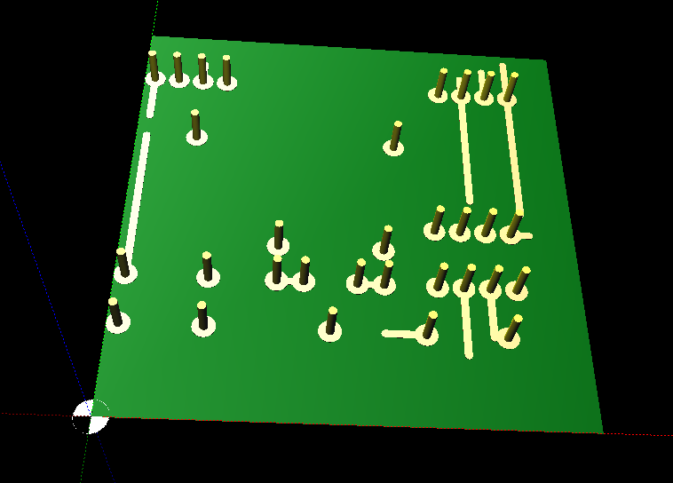

Hi Steve, yes I can! I compared the txt with a 'proper' drl and addedd a G81 at the beginning, changed the suffix and it works. Kind of. The scale and origin seem a bit odd. Here's some photos?
scale and origin seem wrong, but the positioning seems ok
board using fritzing.PNG (37.03 KiB) Viewed 30245 times

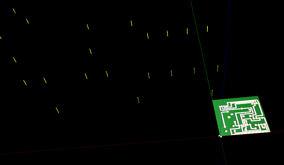

I have also used DesignSpark, and those holes work well, but the board seems to be missing half its tracks:
board using DesignSpark.PNG (62.56 KiB) Viewed 30245 times

Is the PCB output set in inch or metric?
Try setting to Metric, It may be a scaling issue with the drill holes.
I would also try a free internet gerber viewer to see if all the tracks are present in the other package.
Are you using the latest version of VR Milling?
Can you attach a couple of gerber and drill files?

I have also checked the DesignSpark PCB output using GraphiCode GC-Prevue, and it looks good. I'll try upgrading the VR milling to the latest version...
