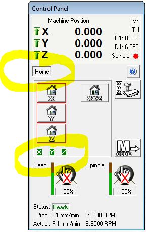

In home mode the status of the datum switch is displayed. If any of the datum switches are operated (the contacts are held open) then the axis is shown highlighted in green.
If the switch has dust holding the contacts apart or you have a faulty switch the axis will be displayed. With the guard open and in home mode if you manually press the home buttons you will see the indicators going on and off.
