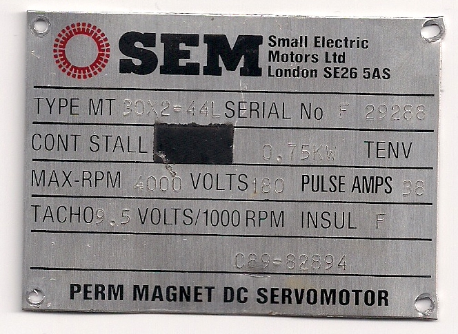

I am having difficulty find information on a SEM type 30X2-44L spindle motor ( Photo of plate enclosed) can anyone help with information on identifying the wires coming out of the motor.
I have contacted SEM themselves who claim to had destroyed all information on obsolete motors can anyone please help.

You Should have 6 wires.
2 x Armature
2 x Tacho
2 x Thermal trip

I know the armature wires which seem to have an earth wire,
but how can I identify the others?
Re: SEM Spindle Motor
The thermal wires should be a dead short & the tacho should give you a feedback of 9.5 volts DC per 1000rpm so if you put a meter on it & spin it manually you should see a change in the voltage.

Thanks Martin that is perfect, I'll be able to sort this out now.
