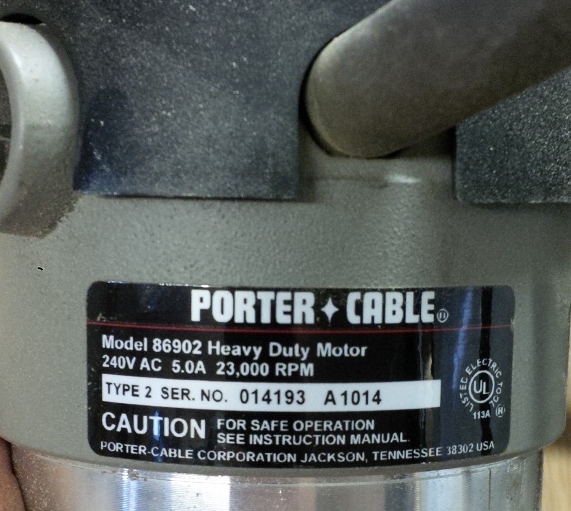

Got a photo of it here. Physicsally it doesnt look like a 1.5hp router and the plate on the contol box does say 0.6hp. It came from a school so I dont think it would have been upgraded as it was hardly ever used.

Just googled the model no to find out it is the 1.5hp model. Very pleased. That has made my day. I just assumed as it came with the 1/4 inch collet that it was the 0.5 hp model. So instead of spending 500 quid I will only have to spend 30 quid to get the half inch collet!
