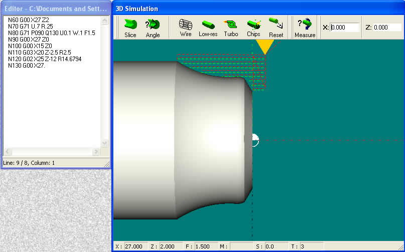

I've run your program here.
At first I had some strange errors appearing and I think that its was because I had copied and pasted the program from the forum, into the editor - because its an RTF editor, it will retain formatting information, unless you save the file, and re-load it again - something to look out for.
Anyway, once I had saved and reloaded the program (and restarted the software), it ran fine in 3D simulation
As far as I can see, the G71 is programmed correctly - I have included a screenshot of the simulation and an example G71 program
PS - I'm using version 1.17 BETA - what version have you got ?
The G71 program simulated
