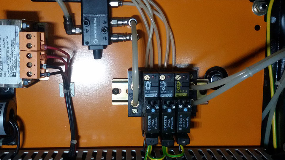

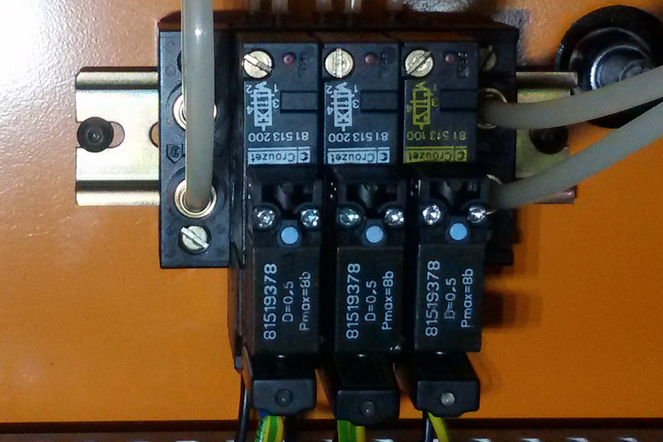

I inverted the pipes to the cylinder last night, the carosel moved forward to the spindle, but when i inputted a M20 to retract it, i still failed to retract.
Put the pipes back on as they should be, then watched the soleniods. When i used the M20 an LED on the centre solenoid lit up but when I used a M21 it didn't.
Don't know if this helps, the machine looks like it has been in storage for a while, so i guess some oil could have gummed up the valve.
Am I right in thinking that test indicates a problem with the cylinder?
I guess I should check the seals on the cylinder to see if any air is escaping.
Solenoid Valves close up.jpg (175.05 KiB) Viewed 34166 times
Solenoid Valves.jpg (150.13 KiB) Viewed 34166 times
Re: Fanuc Triac - ATC Problem
Took the pipes off the top of the cylinder one by one and found that an internal seal had gone.
Went to my local pneumatic supplier in Bristol(Harrier Pneumatics) and got a Parker PIA-5025MS-0150 as a direct replacement for £64.
ATC is working fine now.
