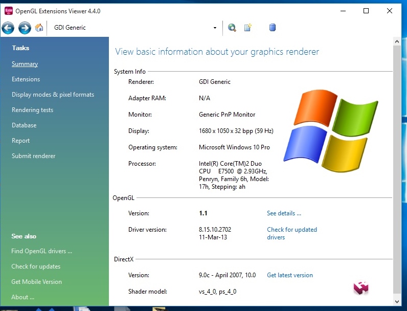

Re: Will VR Milling 5 run on Windows 10
I don't think the fault is with the video card, as it worked with VR Milling until the PC's OS was upgraded from W7 to W10.
The drivers are Microsoft's own and are the latest version. Intel, who made the card, have different drivers, but these are only for W7. They can't be loaded on a W10 machine as an error is thrown up at the installation stage.
I checked my W7 PC which is currently running VR Milling correctly. That has Intel's own drivers, but as the hardware is different not much can be deduced from that.
The video card does support GL version 1.1.
