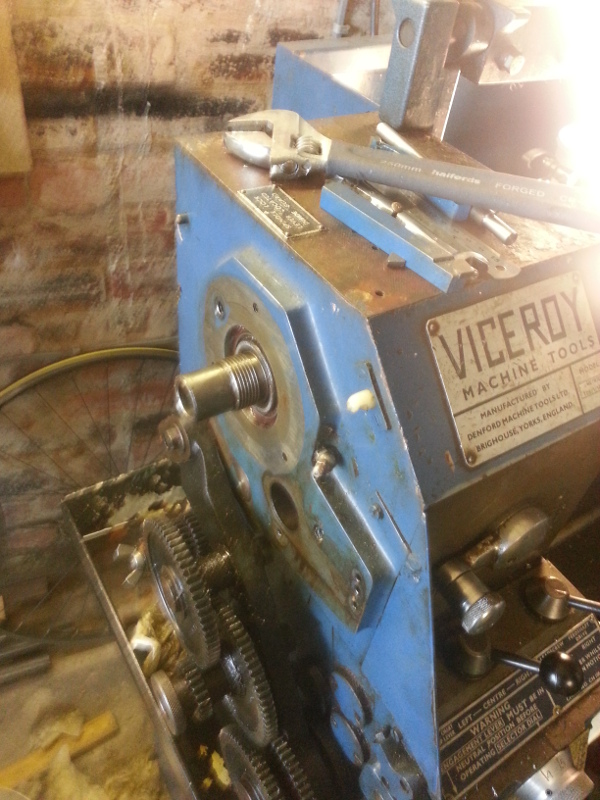

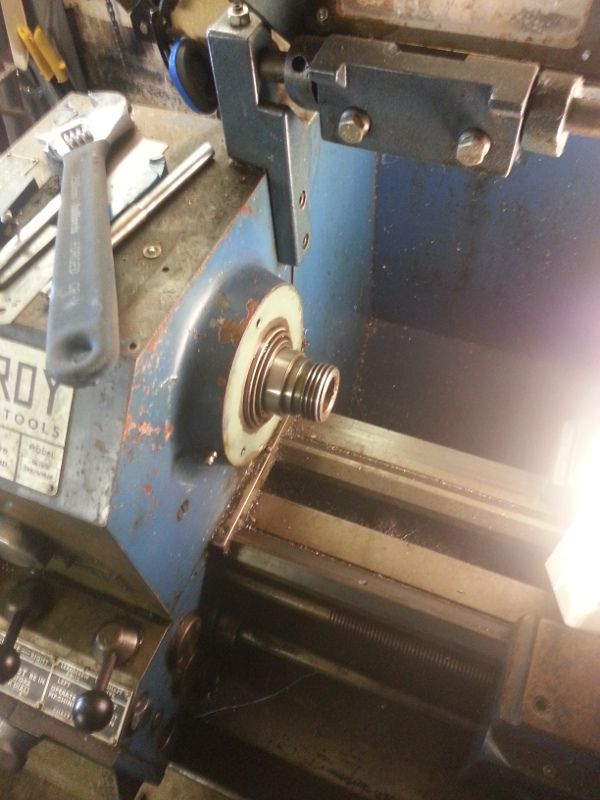

Before I go and damage the spindle/spindle bearings
Hi all. I'm taking the headstock bearings out to check them and clean them if they're ok, if not replace them.
Before i get carried away and ruin some bearings or better yet, the spindle. Is there anything else I need to do to get the spindle out?
I've taken all covers off and lockrings. It looks like the spindle is just sitting there now.
I understand from Dazz' previous posts that i'll need to make some adjustable spacers (bolts with long nuts) to help make sure the gears inside don’t get damaged.
After that's done, do I get my copper headed hammer and tap away at the gearbox side of the spindle, Or is dazz' method with the threaded bar and wooden blocks a better idea?
Thanks!
Gear side as it is now

chuck side with no cover
2015-08-02 14.44.14.jpg (185.58 KiB) Viewed 18754 times
Re: Before I go and damage the spindle/spindle bearings
In the absence of any other replies, I still think my method is the best option.
If you find a better way, please let everyone know.
Dazz
