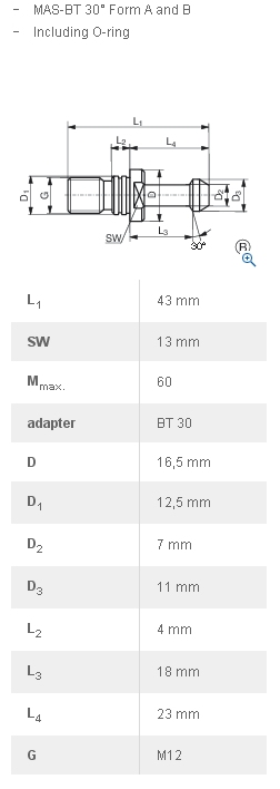

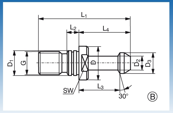

The spec of the pull stud is below so its 30 degrees
PULL STUD 1 14.00 50.00 7.00 MAS-BT-30.30°.M12
pull stud1.jpg (39.6 KiB) Viewed 54711 times
pull stud.jpg (54.87 KiB) Viewed 54711 times
Re: novamill atc retrofit
Thanks Steve.
Just compared that to the dimensions that google images is throwing up, and it seems that's more commonly called a 60 degree, as the diagrams show that angle being measured from parallel with the stud body, instead of at 90deg to the stud like that diagram (got to love non-standard standards!).
