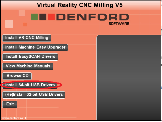

Have you tried installing the 64-bit USB driver from the VRMilling software install page with the USB device disconected?

It will not show up as a printer but you should see the USB device in device manager if it is plugged in & powered up.

Ok, just installed the drivers using the VR CNC milling v5 setup page and they installed successfully.
