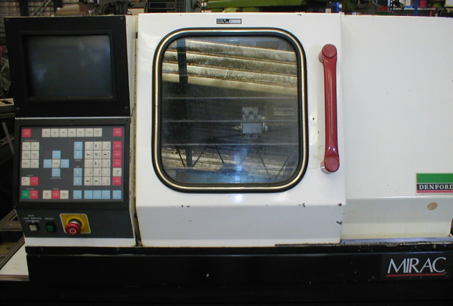

I've had a Starmill for about a year and decided I needed a Lathe, I eventually found a Mirac at a good price and purchased it.
The problem is I don't have any original disks for it.
I have a boot disk for windows 95 which gets me into DOS
I can then run the MIRAC software from the Denford support for older machines, but Get as many others do <Error 128>
Ive tried swapping the com ports arround randomly but with no sucess.
Can anyone offer some advice please, as I don't want to start pulling the machine apart to fix something that is not broken.

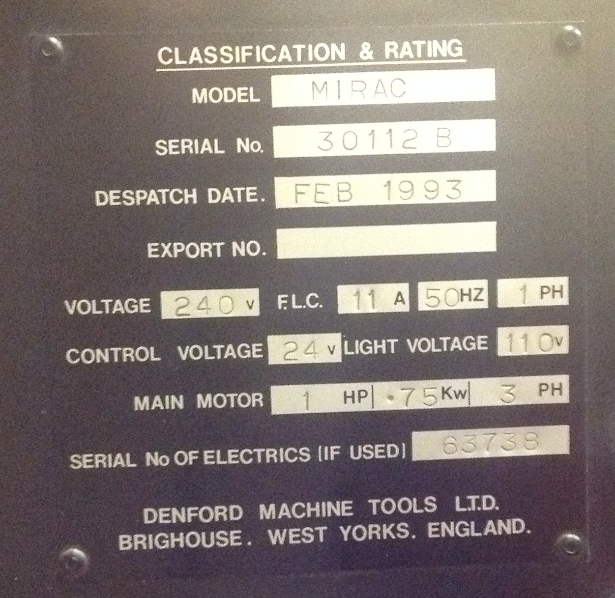

It has a board marked LCB3 (slave board?) which seems to be made by GSM-syntel. s/n 63738
KEB combivert for the three phase supply for the spindle and tool changer,
coolant pump and automatic oiling,
