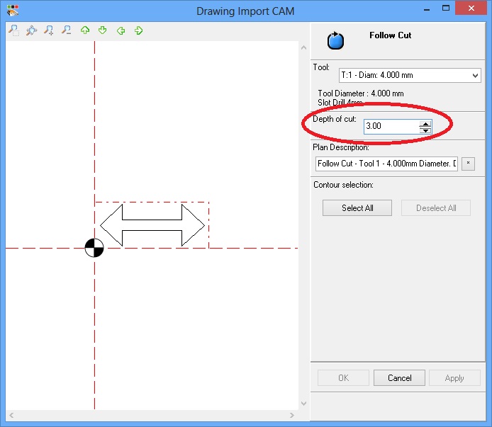

You need to set the depth of cut to 3mm.
If you choose steel the stepdown is set to 25% so it will cut to 25% of the tool diameter per pass. So a 1mm tool would do .25mm per pass & a 4mm tool would do 1mm per pass.
