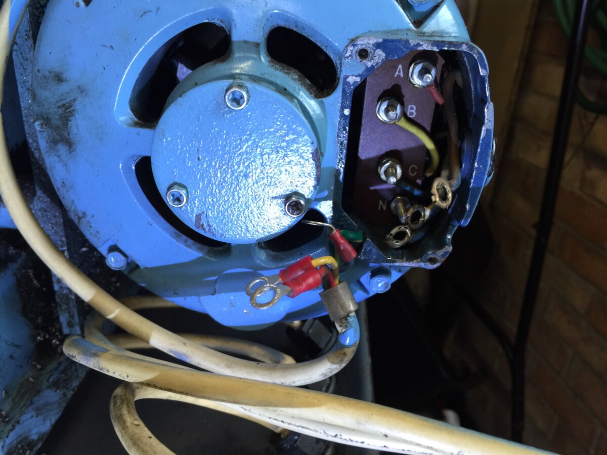

2/ 240v phase Inverter and keep the motor. I see viewtopic.php?t=3127 but cannot see if he kept the same motor. I believe I need to wire the motor into delta 240v but cannot see any connector bars or an easy way of doing this. Has anybody found a way to convert to delta?

If you three phase motor is dual voltage, changing the connections from Y to Delta for 220VAC operation with a VSD should be fine.
The motor currents and therefore the power is the same.
Dazz

I'll go down the vfd route now. Looks like the original motor can be wired delta as there are 3 wires on the n terminal.

Motor is now running on a hitachi sj200 vfd in delta.
