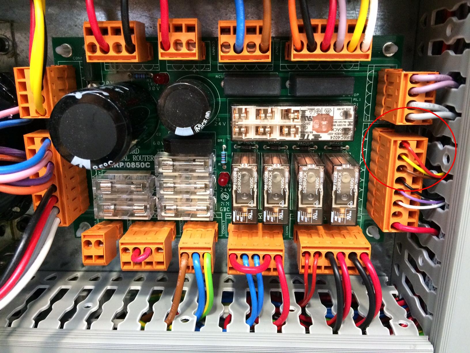

Pins 21 and 22 on the switch the red and yellow are the contacts that let the system know the guard status. With the power off and the guard open these should be open circuit if you measure on the relay board PL8 pins 7 & 8. They should then short out when you close the guard.
It could be worth taking the wires out of the connector too as sometimes the wires have been crimped on the insulation but the wire strands make an intermitant contact

The problem will be with either the switch or connections.
Remove the wires by inserting a small screwdriver in the slot behind the red or yellow wires. you will then be able to see where the wire has been gripped as there will be a small kink where it has been clamped. If the kink is on the copper then the connection is good. I would remove both wires and then refit them.
With the power off if you measure from the red to the yellow wires on ohms or continuity then you should see them connected when the guard is shut.

Thank you Steve for the photo.
Good news is the machine is now working. I followed your latest instructions, both wires looked good and had connectivity. I did notice that the router had stopped close to its limits on the y and z axis, so I manually turned the lead screws to park the router in a better position. Some dust was evident behind one of the micro switches so this was cleaned up. Not sure how we fixed it but on switching back on the fault had disappeared. Would any of the above cause the problem?
Many Thanks
Simon
Re: Guard Open
The micro switches are not related to the door open message You must have moved the wires to sort it.
