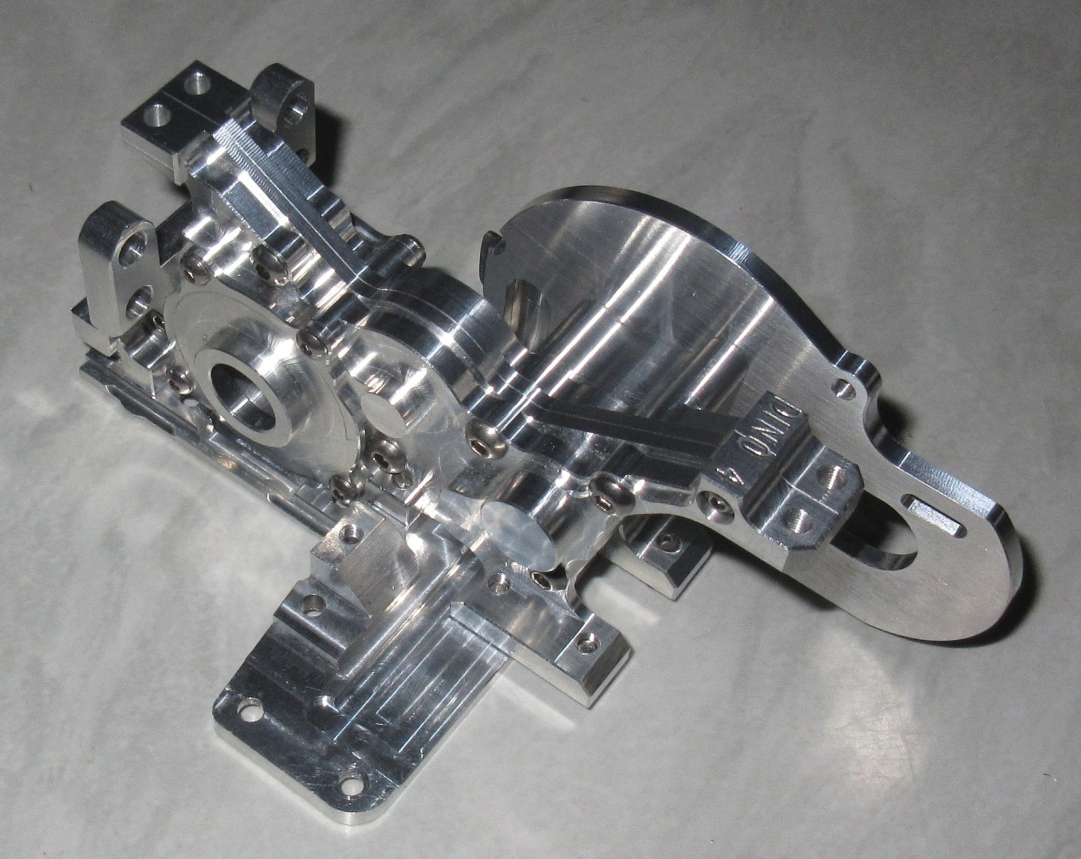

This is my latest project and I have noticed that round things are not round any more and drillings are not necessarily in the right place! If another one is ordered I'm not going to be able to start it unless I can cure this problem.
