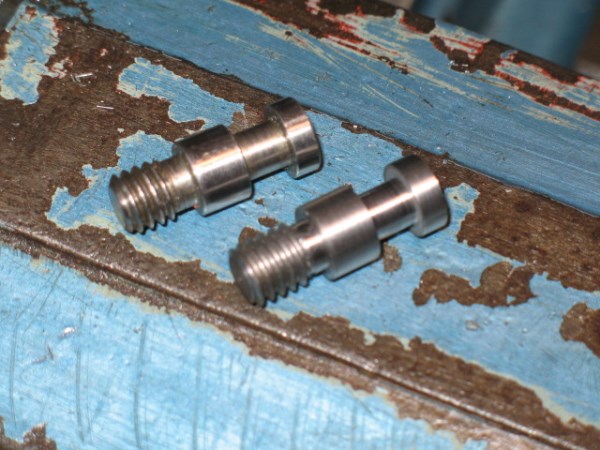

Anchors for the springs.  One of the first things I ever made on the lathe.

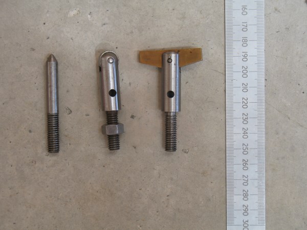

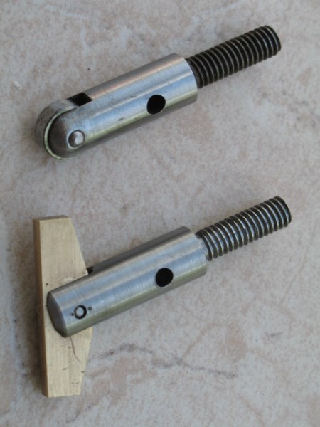

Close up of a couple of followers.

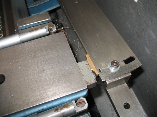

Showing the taper attachment setup.
Another variation of skate used to turn small diameter tapers.

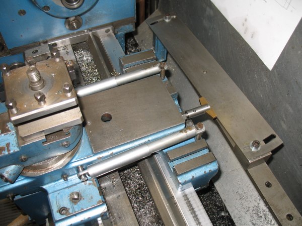

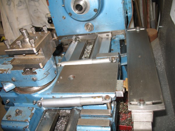

The taper attachment in use.
The taper attachment in use. Note where the spring anchors are located.

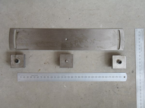

All parts except for the back bar.

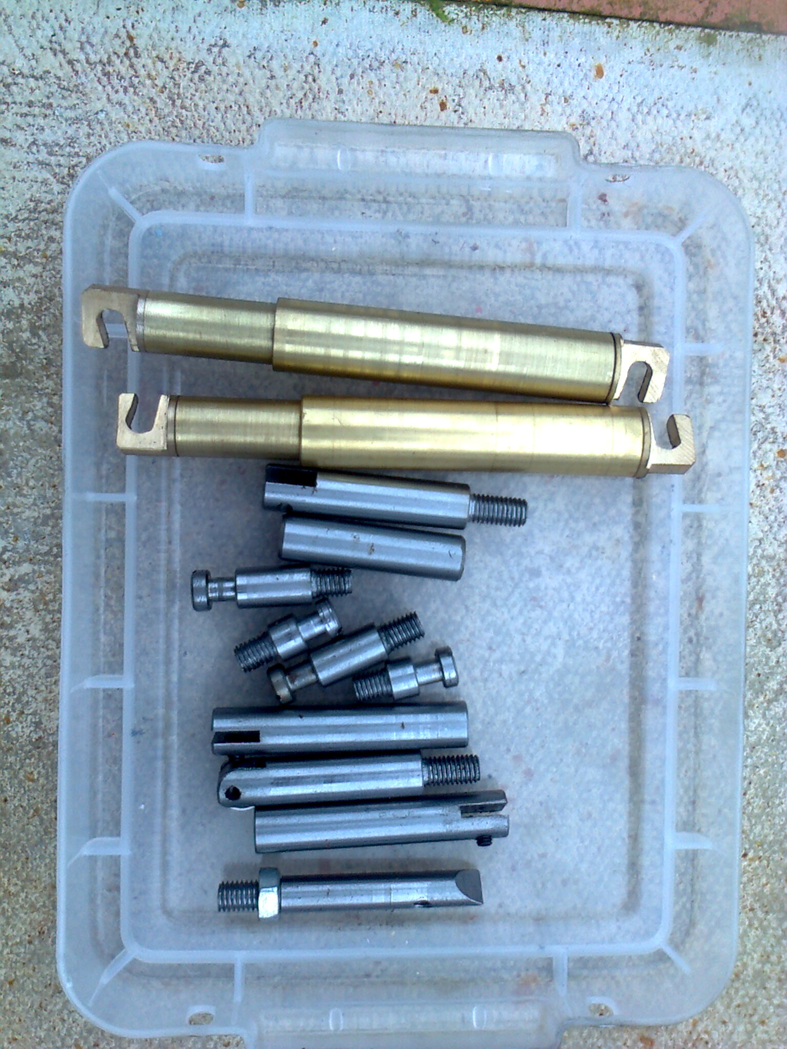

These are the parts for the taper attachment.
These centres hold a turned template.
The left is for following a profile.  Centre is for the taper attachment.  Right is a skate I made for the taper attachment.

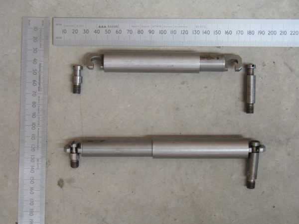

The springs are covered to prevent chips jamming in between windings and making them ineffective.  The outer tube is fully threaded inside.  The length of the springs can be adjusted as required.

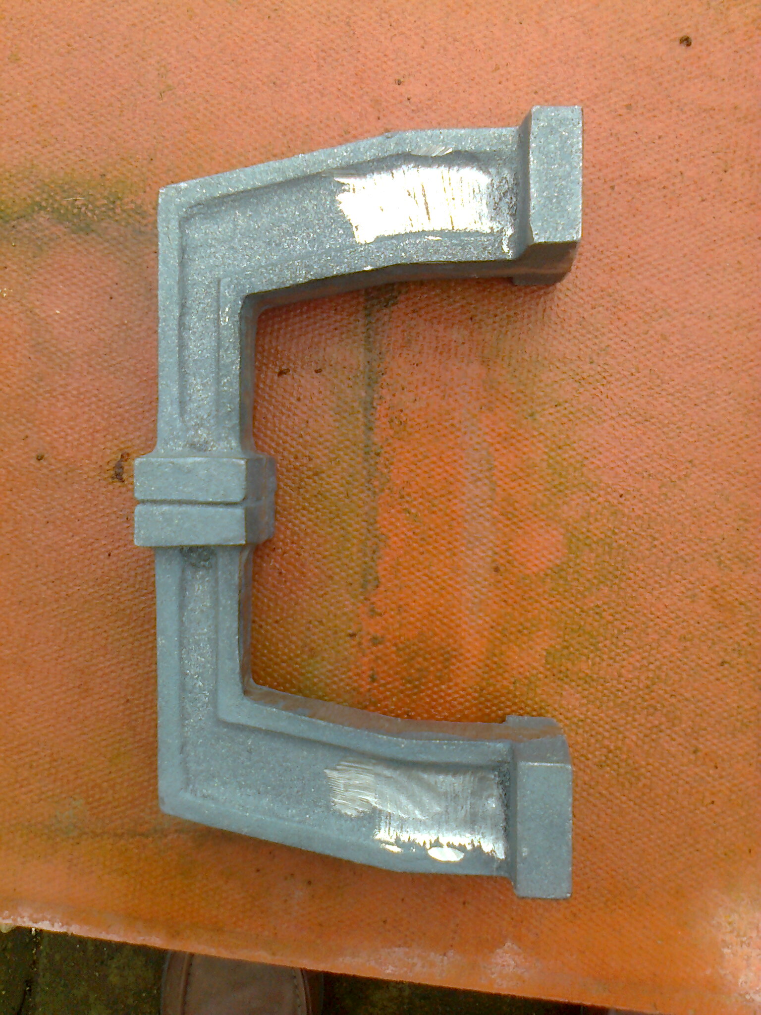

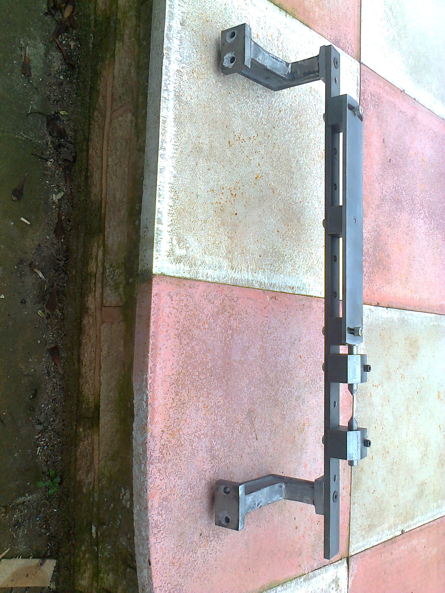

In case anyone is interested, heres some photos of the taper turning attachment I've made. The only change to the available drawings is that I've made the swivelling plate from 2 1/2" x 1/4" MS plate, not 2 1/2" x 1/8" which Denfords specified. Thats because I thought it would give a better bearing area to the stylus or roller, and anyway all I could get for 2 1/2" x 1/8" was sheared plate.
The bracket casting as received from foundry

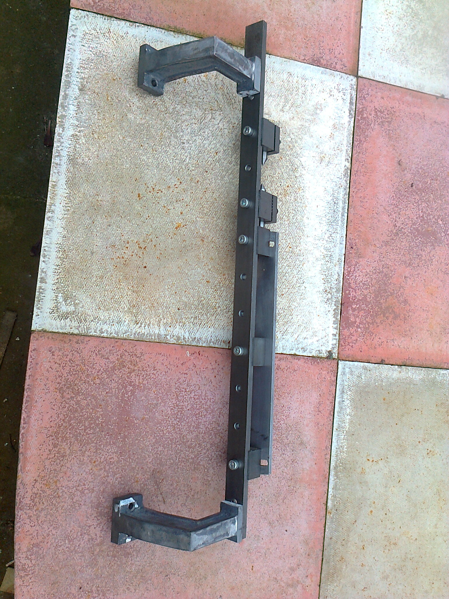

A box jig for drilling the long rail
I made a box jig for drilling the long rail, because I don't have any DROs, and it seemed necessary to me to have all the holes in line and at regular spacing.
Now all I've got to do is move the lathe away from the wall and get round the back to fit the thing. The facings on the back of the bed seem to have been machined, but not drilled, nor are there yet any drillings in the cross slide for the stylus and the spring anchors.

Nice.
Looks at least equal to the factory version.

The spring housings are shown on the GA for the attachment, so I used that as a starting point, plus a little imagination. The outer sleeve is 16G brass tube, 3/4" OD, and the inner sleeve is 16G brass tube 5/8" OD. If anyone is interested, I'll scan my sketches and put them on here.

Hi Daz, i have The original Taper attachment, I have the wheel guide one in pic 2, but thought your other guide very neat, what materials did you use, i would like to make one. If you get this post, on another subject I noticed you put some photos of the rebuilding of the apron. I am not sure what the 2 hole are for on the right side of the apron 1 near the flip top oiler and 1 near where the dial indicator is. I have posted these on the site (Alan's Viceroy), but am confused what they are for. Thanks for you time, Alan.

Just mild steel and brass, straight out of the scrap box.
