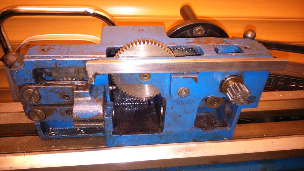

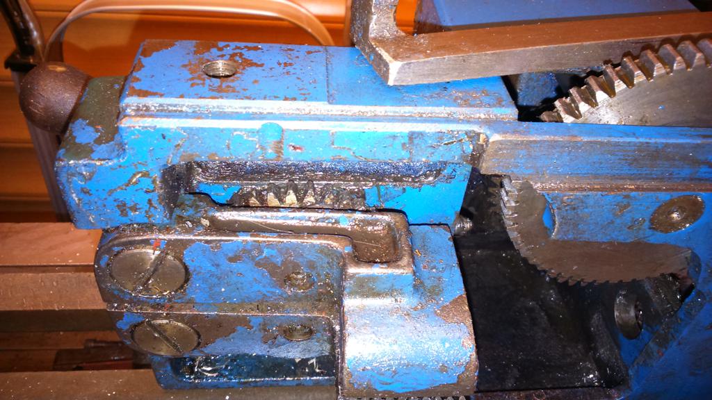

The arrangement is actually quite simple - there's a stop that clamps to the bed, much in the manner of the auto-feed clutch knock-off on a Boxford lathe, which then activates a cranked rod with a piece of rack gear welded to the other end.
This turns a gear that's attached to the half nut activating shaft, and the half nuts open at the appropriate time. Part of the rear casting of the apron is removed to make space for the activating rod.
I've attached a few pictures below that should make this a little clearer. The rack is the same pitch, it appears, as that along the front of the bed.
One immediate observation I have is that the precision of the stop may perhaps not be too good, as the half-nuts will only open 'as fast' as the rod is pushed in by the stop - some biased-open over-centre arrangement would have been better.

Close-up view of the gear on the half-nut lever shaft (excuse the muck....)
half nuts and gear.jpg (114.26 KiB) Viewed 17751 times
Overall view of the apron rear with the half nuts in the released/open position.
open overall.jpg (91.42 KiB) Viewed 17751 times
Overall view of the apron rear with the half nuts in the threading/closed position.
Closed overall.jpg (90.36 KiB) Viewed 17751 times
The cranked rod with the rack gear welded on the end.
cranked rod.jpg (84.79 KiB) Viewed 17751 times

The knock-off is rubbish. Constant use would round off the edges of the half nut threads. The slow release would provide uncertain release.

Surely this isn't a Denford original fitting? To be useful, it would need to spring the half nuts open, not just gradually open them. How is it reset, does the operator have to manually pull the bar out each time? As a safety device, yes maybe it does have some merit, but as a device for releasing consistently when screwing up to a shoulder, then no, I don't think so.

Yes, it is factory original. Not the best designed feature. It is more of a push off than a knock off.
It is reset with the half-nut lever.

The only tricky part of the bar is the tooth rack that engages with the gear teeth on the half-nut lever. Given the application, I would make this with a hacksaw and files if I needed to.
