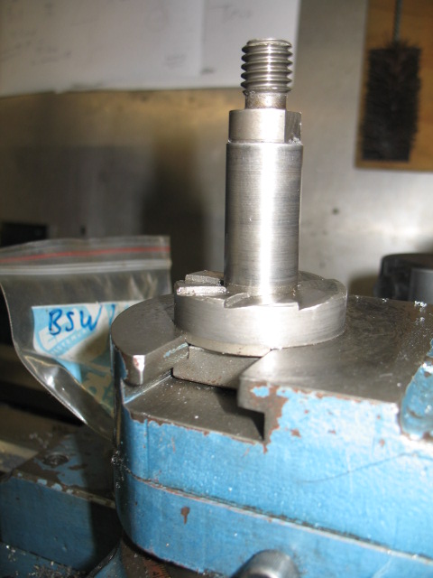

The Denford method of attaching the topslide to the cross slide is very similar to that used by Raglan, and Raglan copied the system used by the American Atlas lathe. Tony Griffiths suggests that an Atlas vertical slide will in fact fit a Raglan. I don't have my Raglan anymore, so can't check if the Denford and Raglan spigots are dimensionally identical. The original Boxford was supposed to be a Southbend, not an Atlas clone, and the photos on https://www.lathes.co.uk site show that on the Boxford, the spigot is on the topslide, or vertical side, fitting into a bore in the cross slide, the exact opposite of the Denford/Raglan/Atlas arrangement, so I don't think a Boxford vertical slide will readily fit a Denford.
According to the assembly drawings, the spigot projecting from the top of the cross slide is a separate component, not integral with the cross slide casting, and is retained by a Mills pin. I've just looked at my spare cross slide casting, and this is indeed so, but the Mills pin appears to have been inserted from one side only, so no way of getting it out to remove the spigot in order to fit a male vertical slide, without drilling the pin out, so Denford obviously didn't intend the spigot to be a removable item.

Re: Vertical milling slide for TDS 1/2 PCS?
I think the problem with fixing it on the topslide instead of the toolpost(which would be very easy), is that it would make the vertical very high relative to centreline, and I'd have doubts about how much useful milling could be done on it. A lot depends on the size and type of work the OP has in mind.
The Denford vertical slide looks to have been made to fit on the cross slide in place of the topslide, which would be quite a bit lower.
OK, I see that the Boxford and Denford have different spigots on the bottom of the compound.
