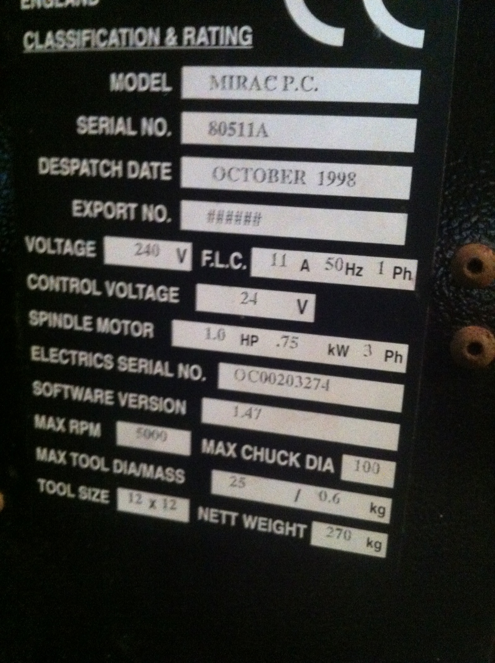

What age is your machine and are you using VR Turning software with it now?
Re: threading with lathecam
hi steve
i use lathecam only or write programs by hand.
it seems miracpc only accept ".mir ".
mirac software use actually usuals tools, rough, part, boring bar, but don't know internal threading tool.
it can used "g71 two lines" and "G76 two lines", so you can do manualy programs to internal boring and internal threading.
sorry for the picture size
gilles
