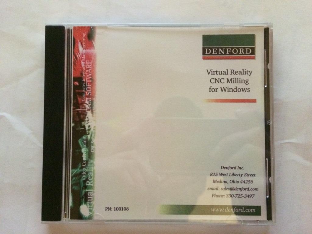

Upon further searching through all that came with the mill, I found that I had overlooked this CD.
Since the computer I have does not have a floppy disk drive currently, would this CD work in place of all those floppy disks?

the licence will be on one of the floppies, so you will need to get that off the floppy. You can just store the file on the HDD of the PC and then when you install the program from the cd it will ask for the licence disk, just point it to where you saved the file.
I noticed you have a 'dongle' that plugs into the parallel or 'printer' port (NOT between the RS232 25pin plug and the machine) on the computer I am 99% that will be so you can run mill cam designer which I saw a floppy for.
