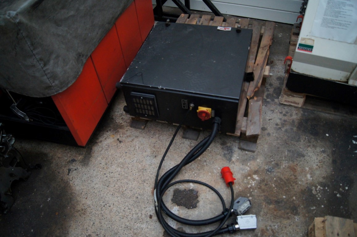

Hey,
i have a Denford Cyclone with Fanuc OT-B controls. I cant seem to find any tags on the machine telling me the production year and so on. But it is the model with the big black transformer box and 380V input.

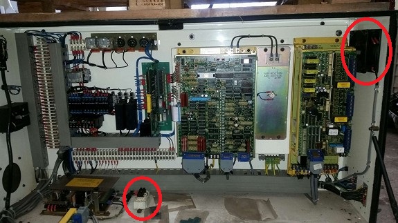

The problem is that i don`t have 380V at my house, so i went to a place were i tought there was 230 3phase available. And i got my self a 230v to 400v 7.5 KVA transformer box to get it up to 380V for the machine. But the problem is that some retards have used a blue 230V connector were there was 380V in the cable. So i powered the 230 to 380v transformer with 380v and then that one powered the denford transformer box with the double of that! lets say 800V!
So when i switched on the denford transformer box the cabinet fan began smoking and i think a small transformer for the cabinet lights blow up.
Now i have connected the 380v direct into the transformer box as it supposed, but the cyclone wont turn on. Ive checked absolutely all electronics, nothing seem to be burned or broken. So what do you people think could have taken a hit her? which components should i check?
I dont think there have been high voltage to the system electronics because the denford transformer box was never on while the high voltage was on. And it was turned off pretty fast.
Because now when i supply with the correct 380v and press down the breaker in the big black box the transformers starts making sound, it did not do that the first time with high voltage. But still no power to the cyclone. I believe there is some problems with some controlling power because the breakers are not activated when pushing the green "start" button on the cyclone.

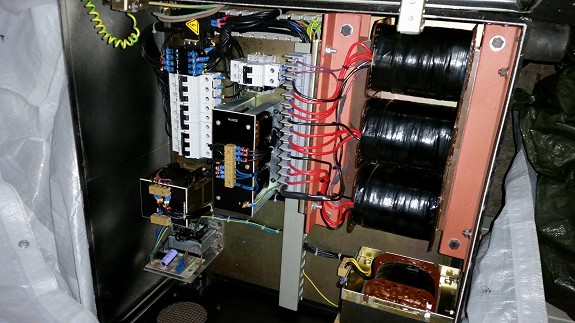

This is the two parts that i can see that blew up.

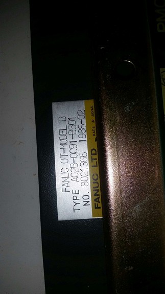

The serial plate should be on the side of the electrical cabinet.

The plate doesnt exist on my machine then :/ is it glued on? Because i cant see any signs of anything been there either.

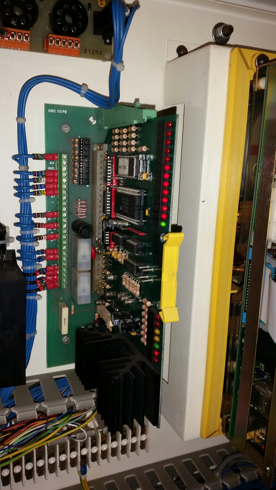

Okey solved one problem now! The two big connectors was plugged in wrong! They was suppose to be the other way around. Strange that the design let me do that. But anyways. Now there is power down to the electronics, but there is a red diode blinking after i press the green button for "control on". And the screen is not turning on. Anybody know what this red light means? I think it is on the input module.

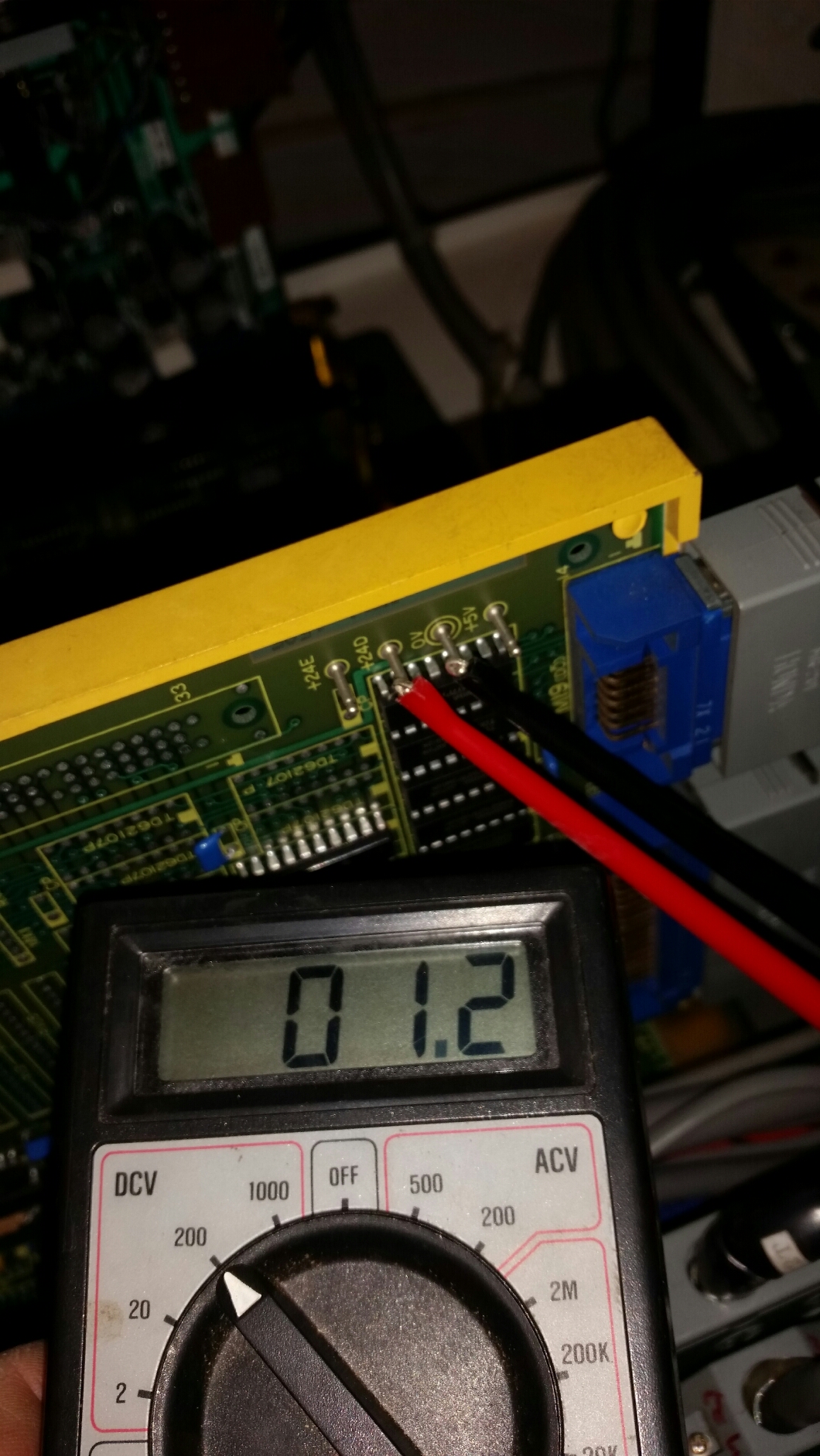

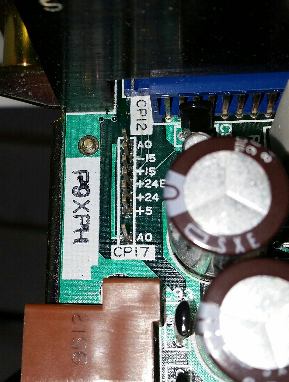

But ive been measuring voltages in the power unit on the test points. Here are the results.
5v : 8.4v dc
24v : 45.2v dc
15v : 28.5v dc
Pretty high arent they?

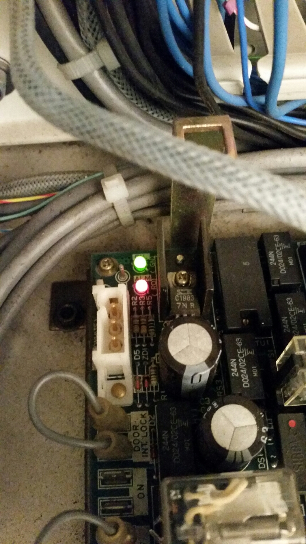

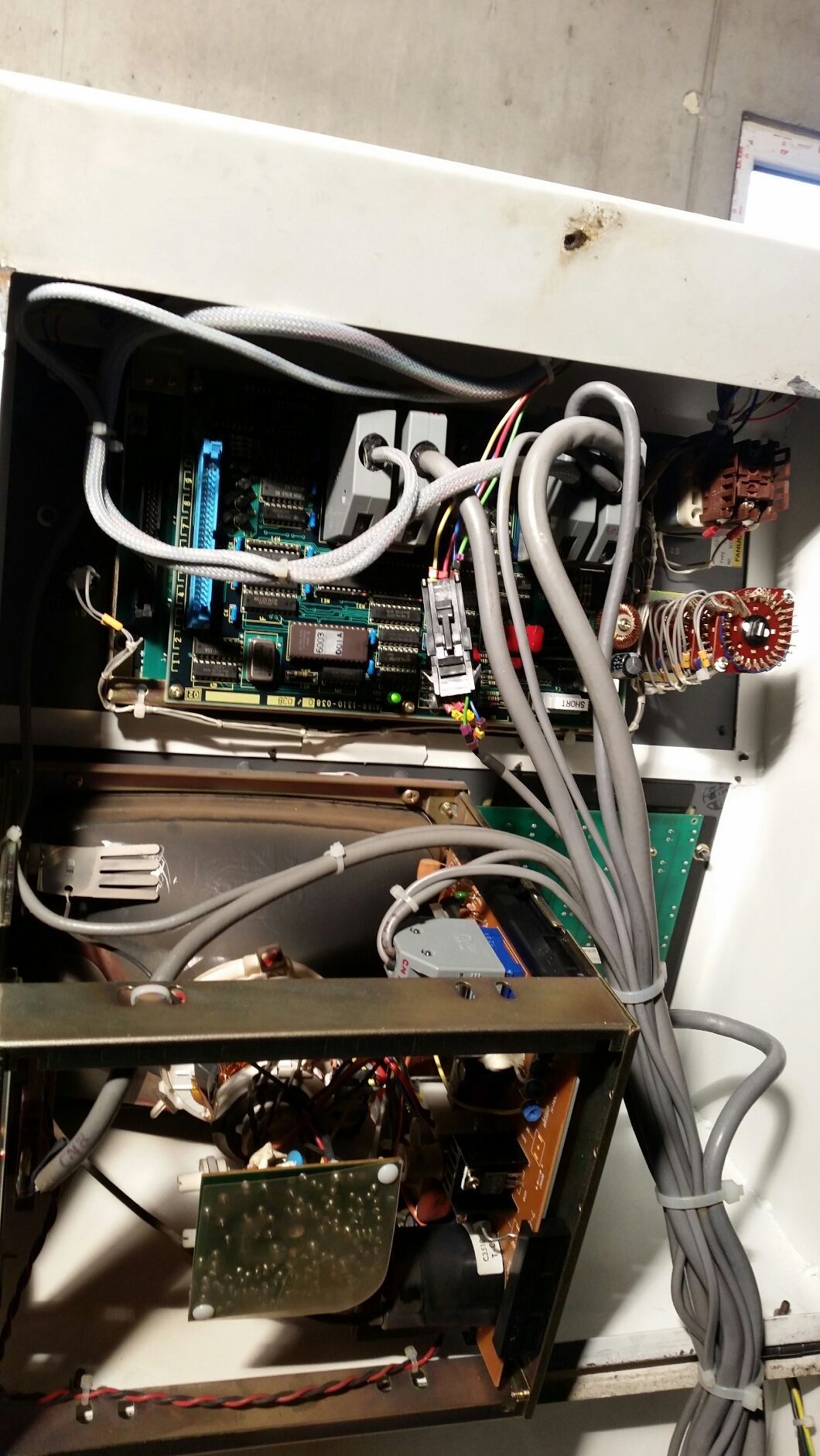

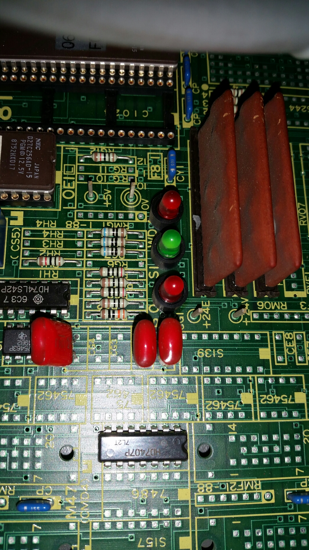

The status now is that there is a small relay kicking in when i push the control on button. But the screen doesnt come on. But there is a flash in the screen when i press the control off button, so i believe the screen is working then.
There is also light in the diodes on the input/output card. ( see picture).
And there is a small green diode that starts blinking when control is on, on the backside of the controlpanel and display(see picture).
But there is no light in the leds on the fanuc control card, should there be? (See picture)

Hmm now i found more test pins on the control card. There seems to be a faulty power supply on the 24v system, or is it a short somewhere? Maybe a limitswitch or something?

Great! :D But when i look at the pictures again i see that the 24volt pins have a D and E back of them. Does this mean DC and Earth? Because i have not tried to measure anything between the two pins, only to 0V.

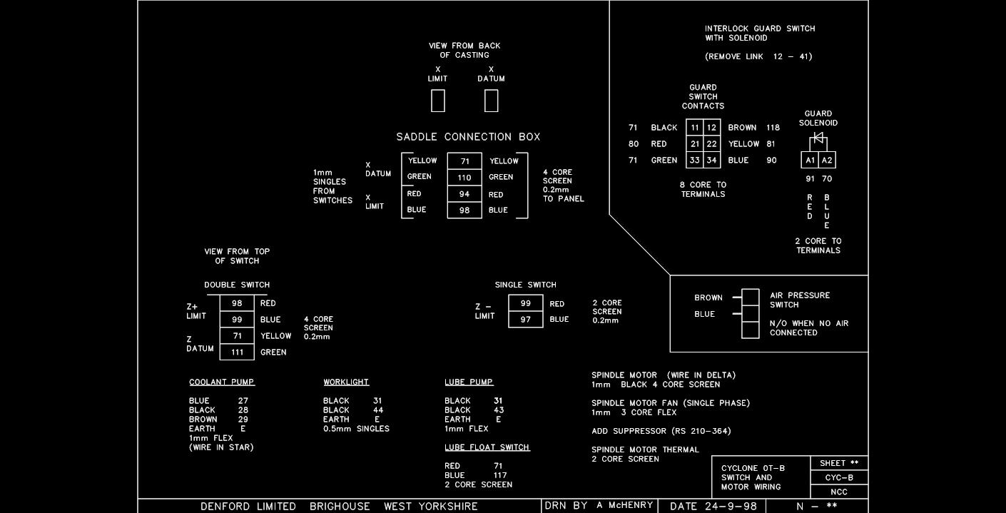

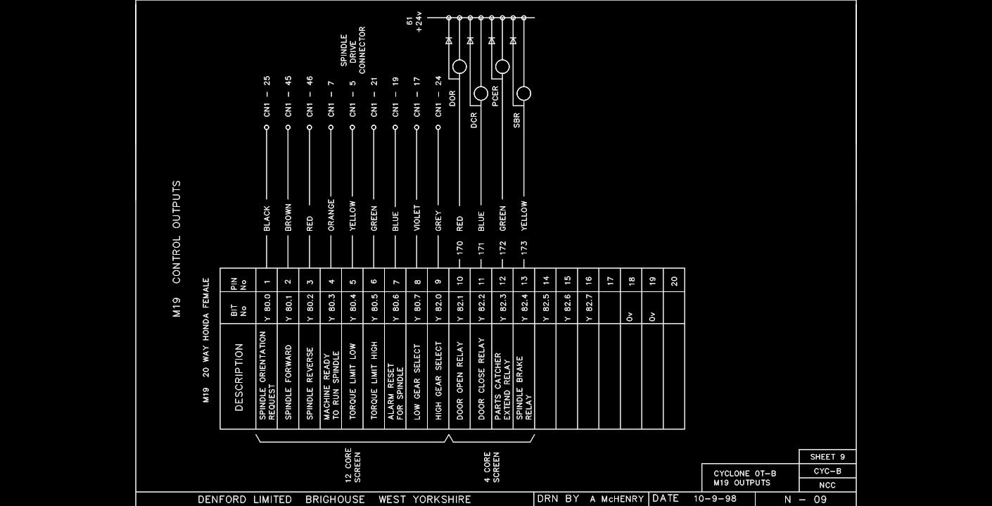

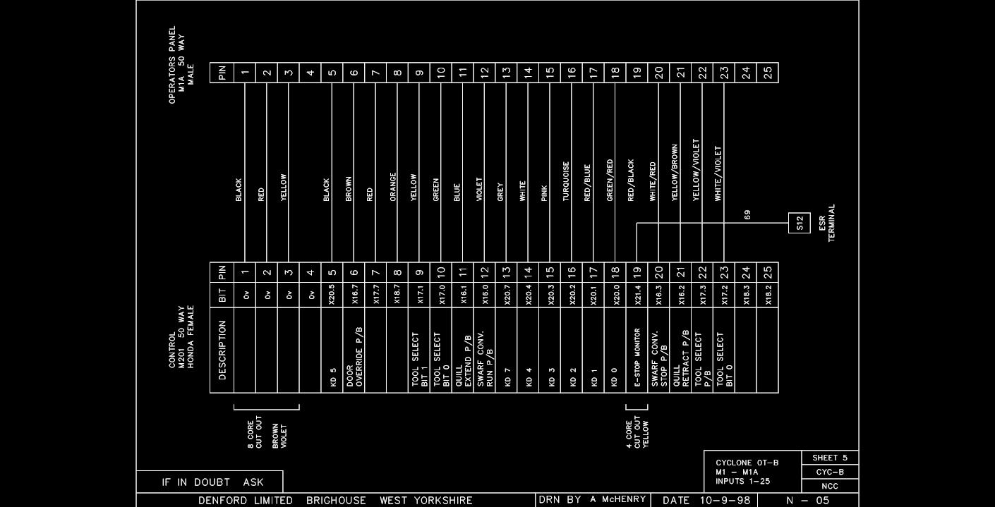

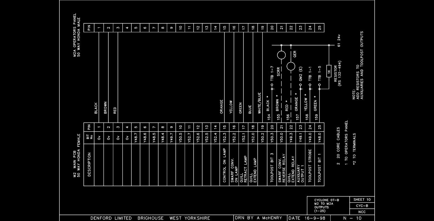

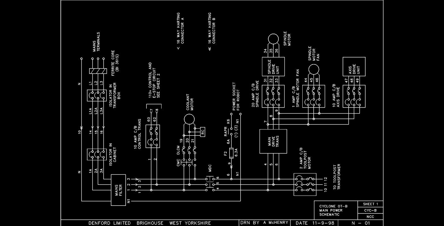

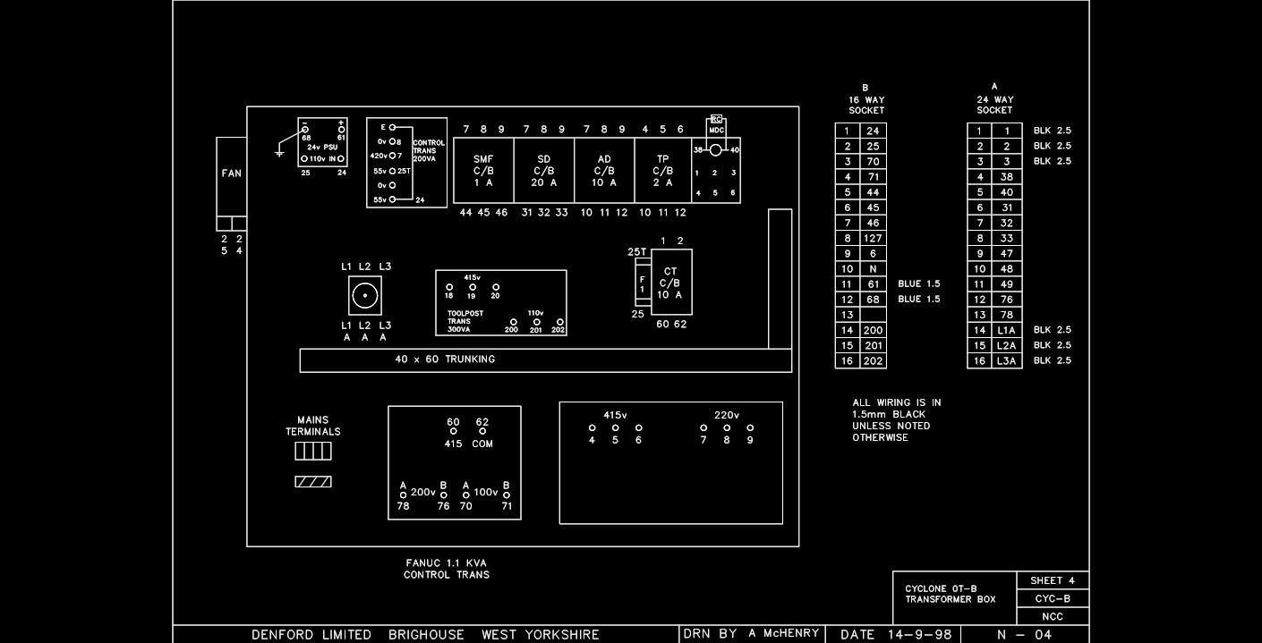

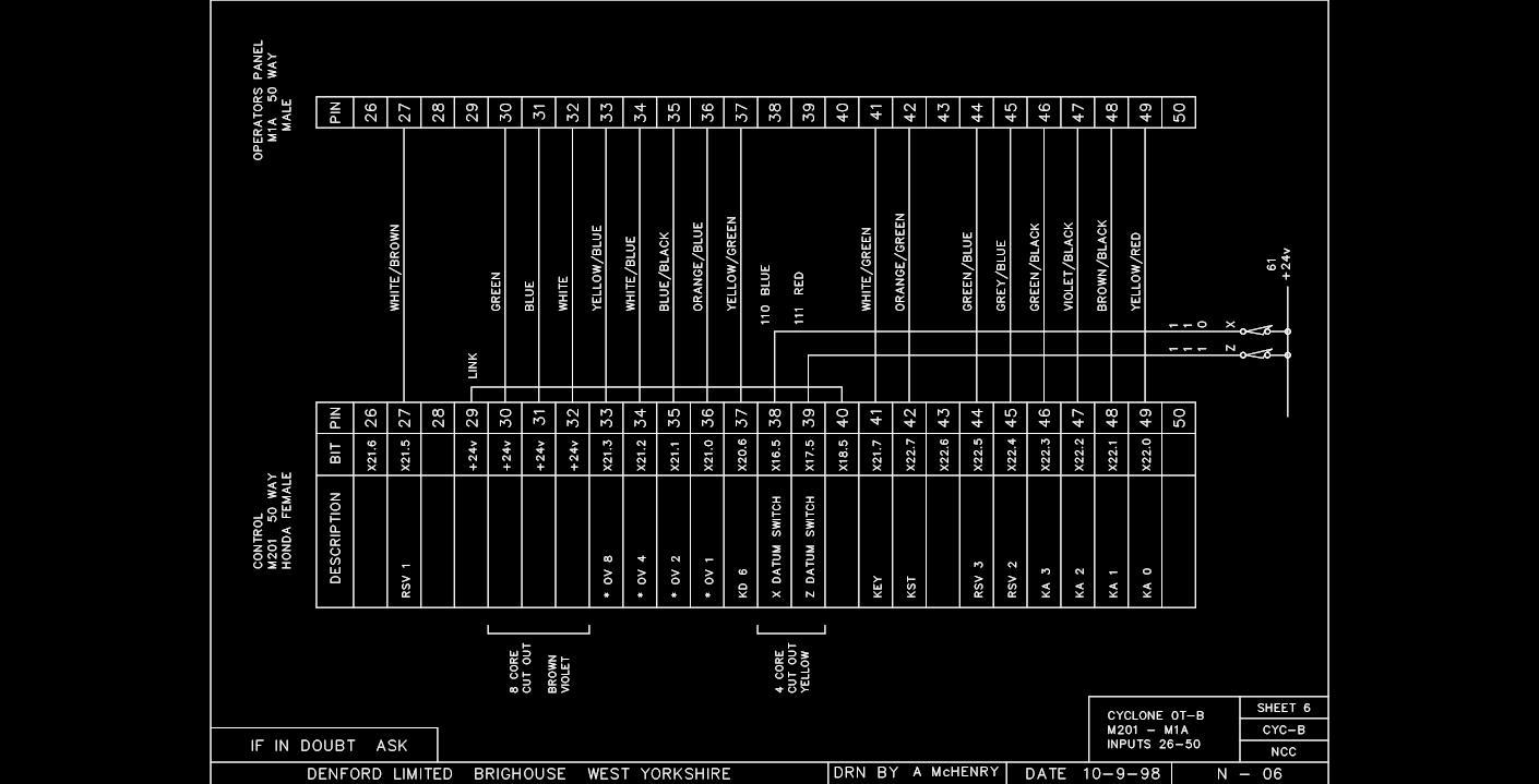

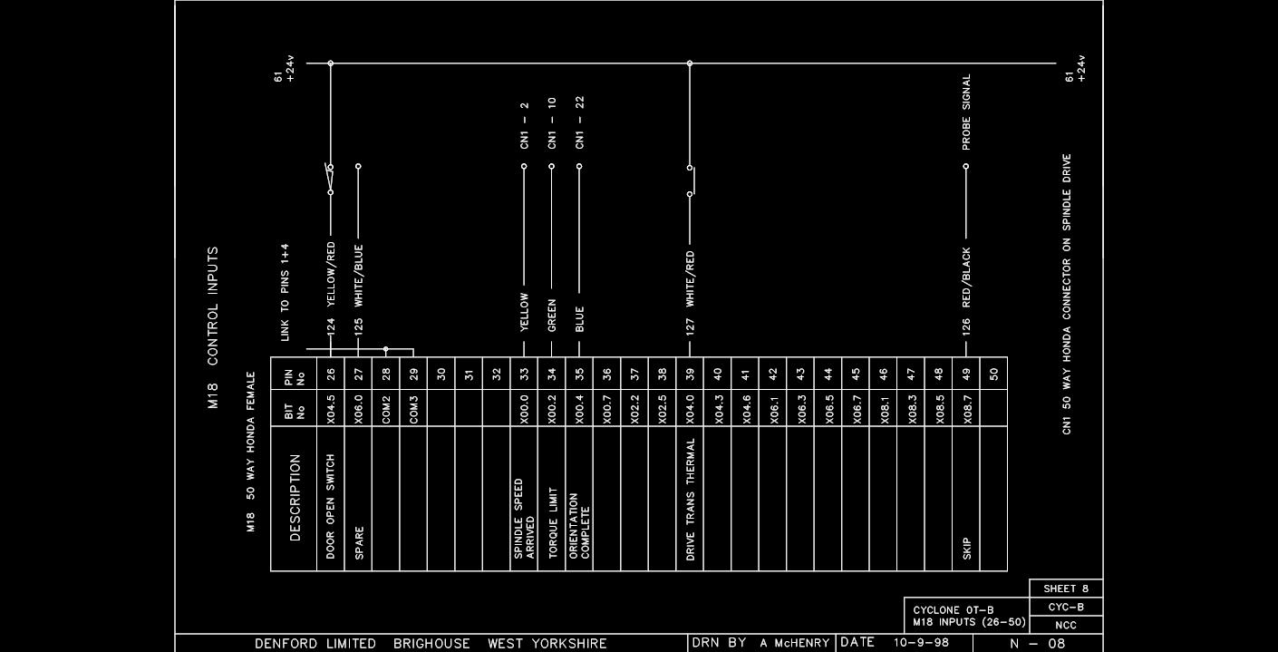

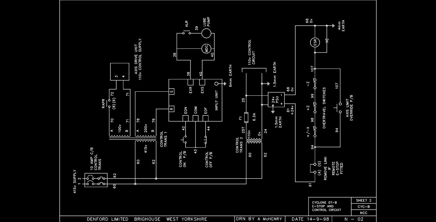

Attached electrical drawings
Re: Cyclone doesn`t power up
Thank you very much for the electric drawings! :D

After changing the power unit module A16B-1211-0850 with a new one the machine is now starting up :D That's good news! But now i cant do anything because i get "NOT READY" and some numbers on the start-up screen that says "0615 - 07".
I can go through the menu for parameters and diagnostics. All parameters are in as they should. But after some research i have found that diagnostic NO 0021, bit 4 should be 1 when E-stop is healthy, mine is constantly 0. So i think there is something wrong with the estop control and maybe those numbers can guide mw in the right direction to where to check things.
