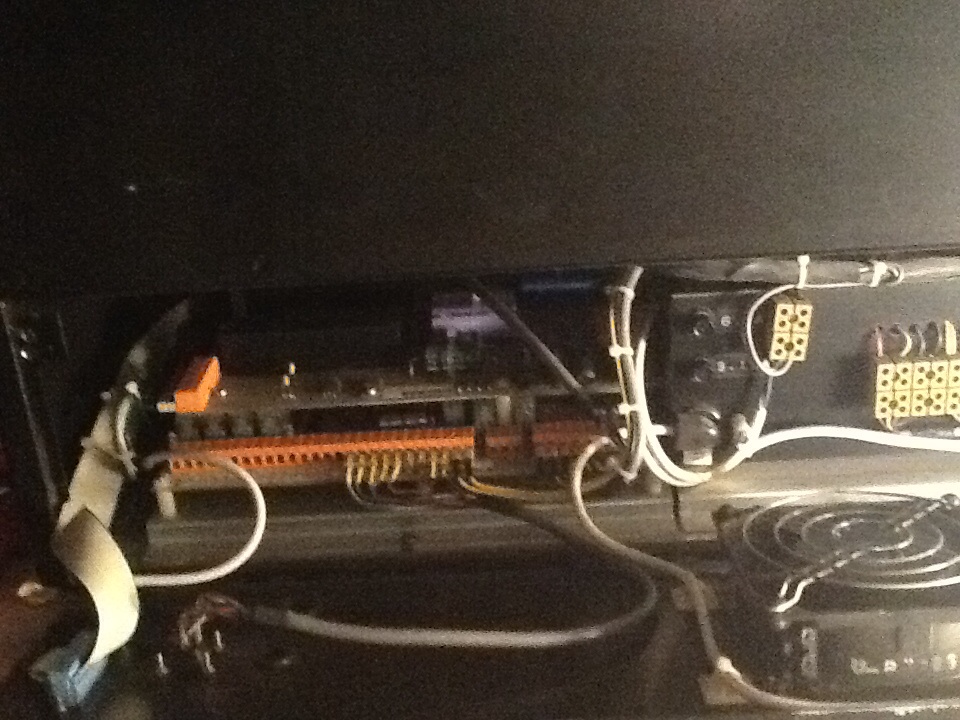

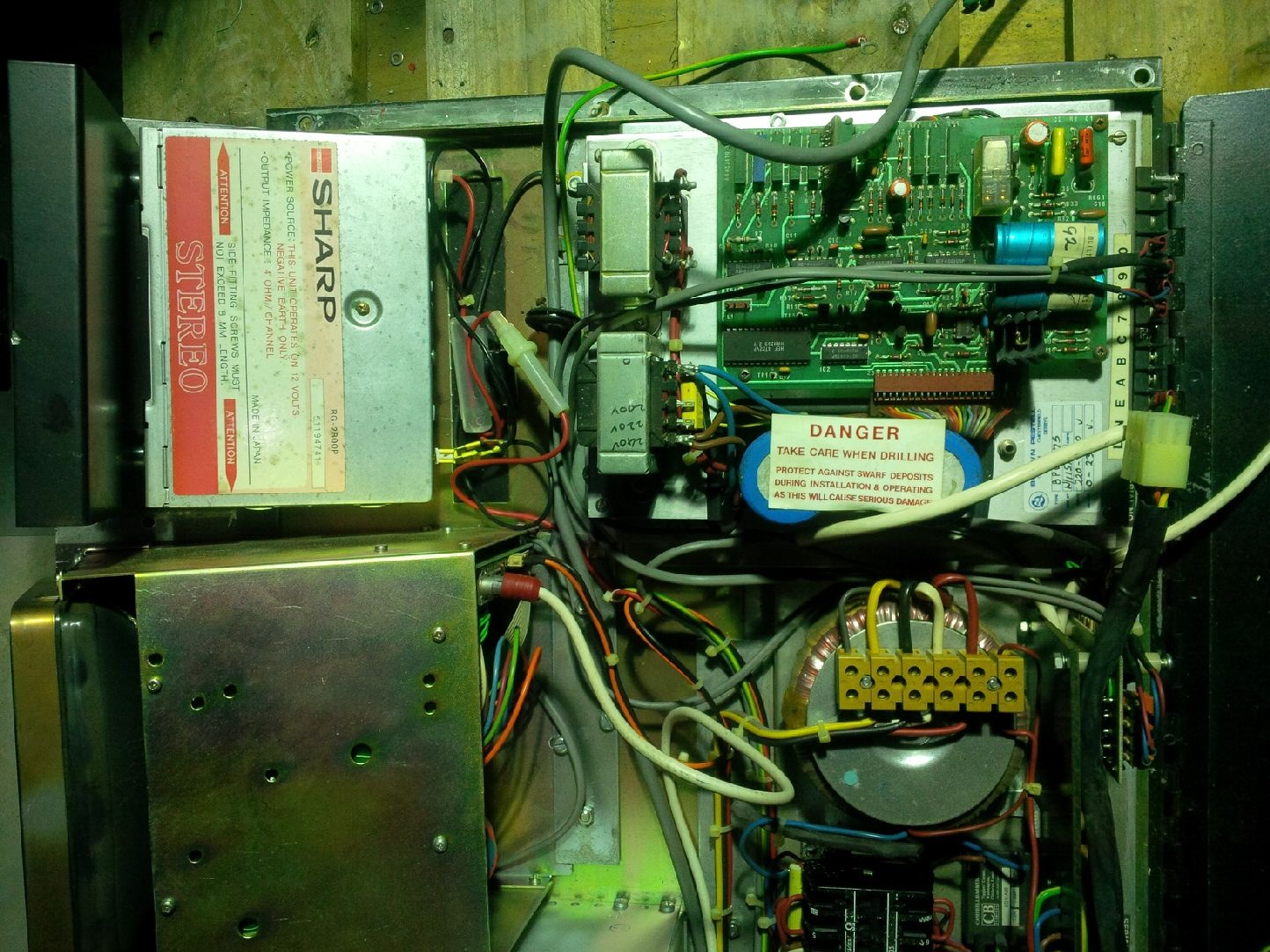

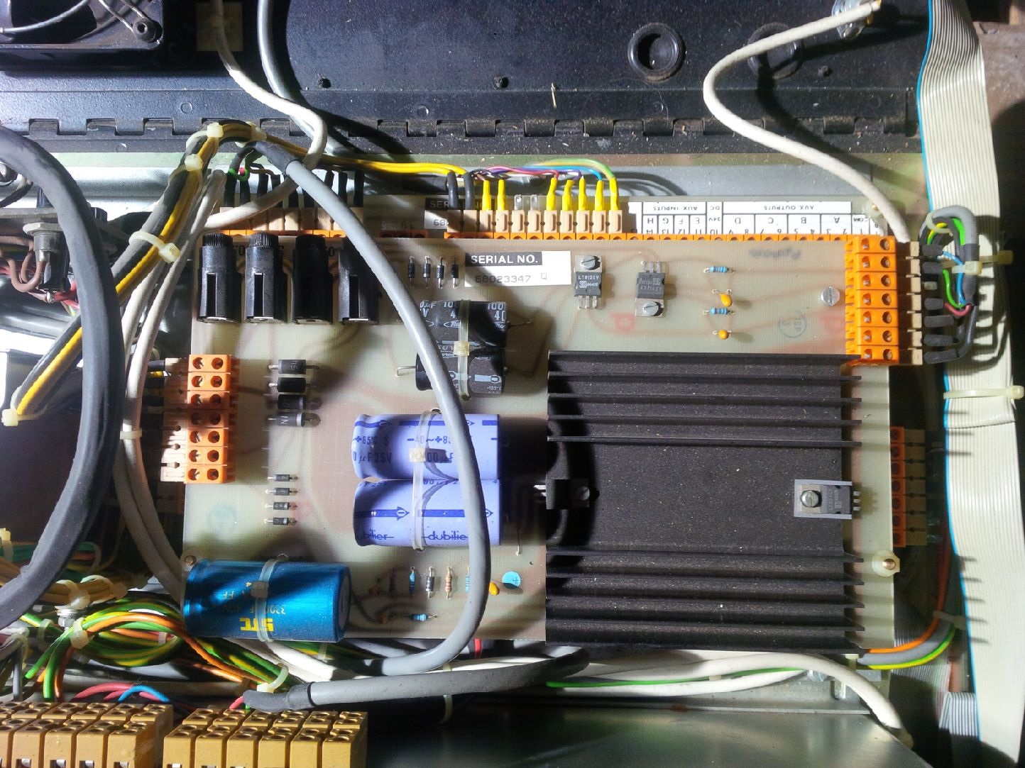

that's an early orac, and possibly it has the wrong drivers in there. Can you measure the supply voltage for the drivers, and take a photo of the power supply.
Re: Denford Orac. Not moving in Z and X axis

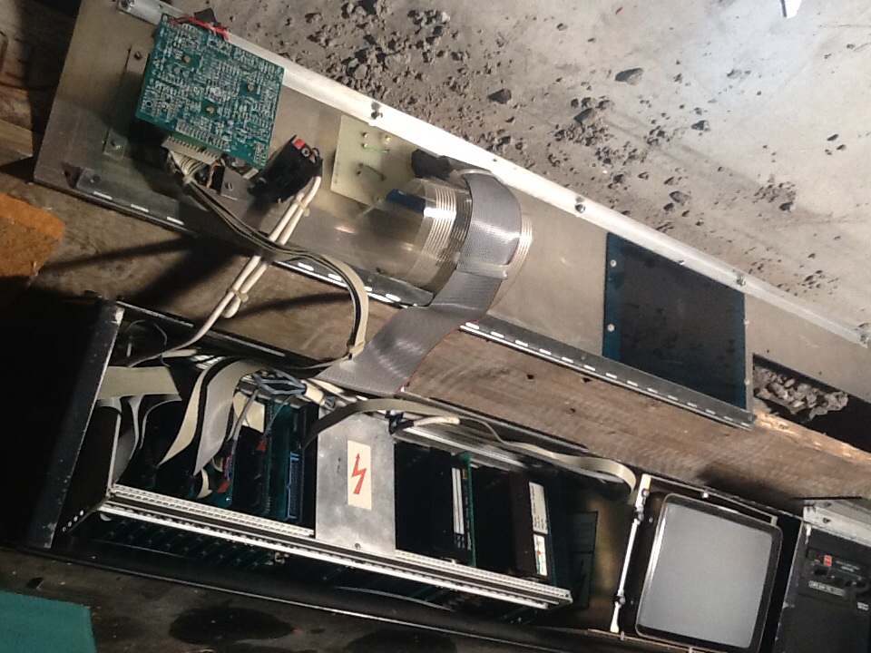

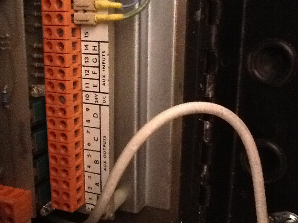

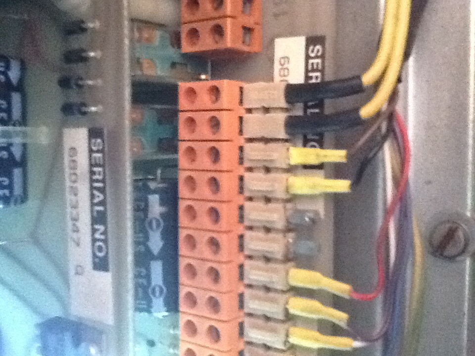

Here are some pictures. I can take better and more pictures, but maybe it's good enough?
can you take an overall picture of the electronics
More pictures
that is an sd2/3 drive, a lot of the earlier oracs had cd20 drivers and they are not interchangeable.
can you take an overall picture of the electronics.

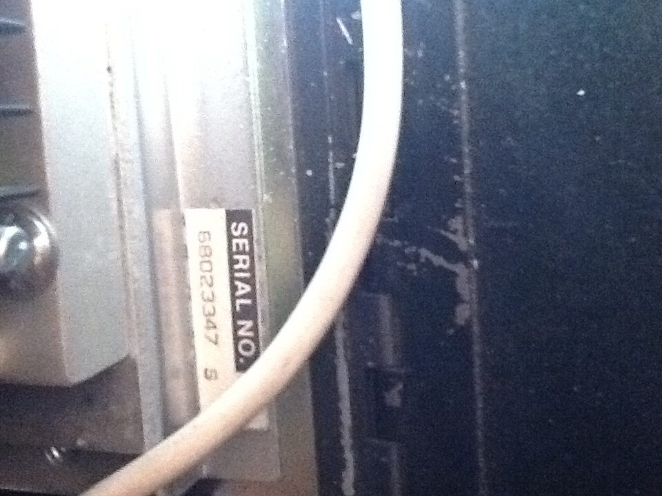

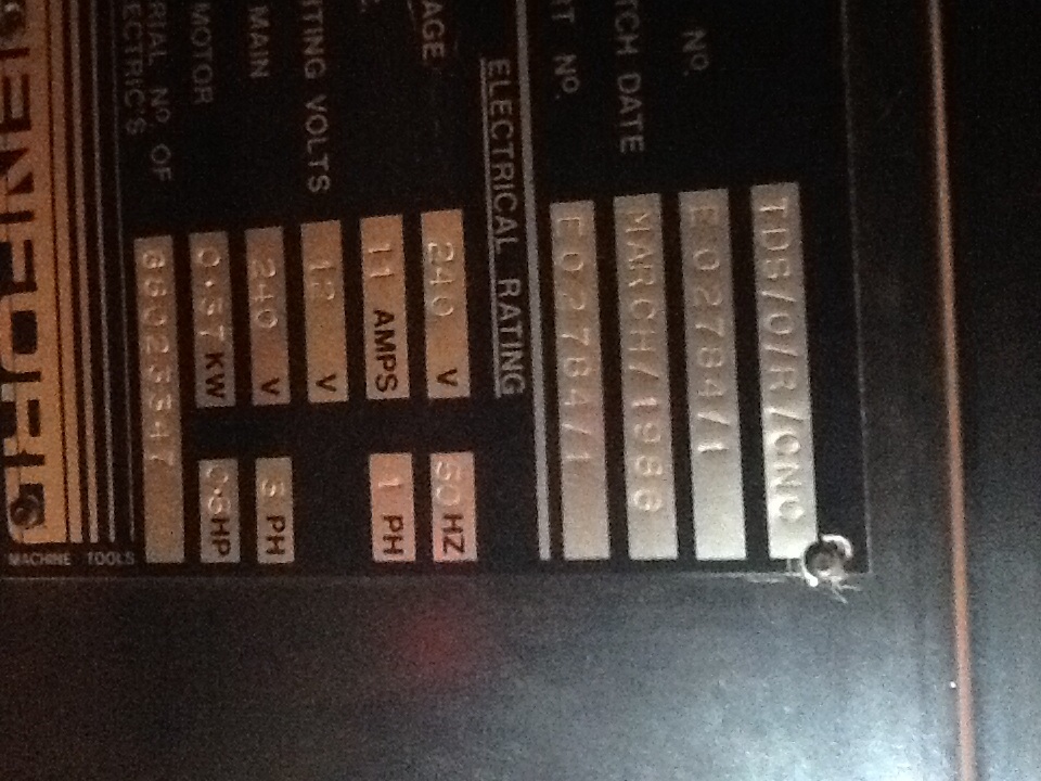

Unfortunately it's not clear which version the lathe is and to tell you would have to separate the base panel from the lathe body.
So you mean that I need to lift off the lathe with bed from the electronic base below?
sorry that was a bit misleading.
The base is made of two parts, the main part is the sides and upper which is one piece with the lathe on top, and the second part is the bottom plate which has all the electronics mounted to it.
If you put the orac onto it's back you can unbolt the base plate and it will open on the back hinge to expose the electronics. There are five bolts down each edge and one screw on the front towards the left end next to the screen. Be careful when opening the base plate as the inverter output wires may not be long enough to allow the plate to open fully and may need to be disconnected. Double check that any other wires are not caught before fully opening the base plate.

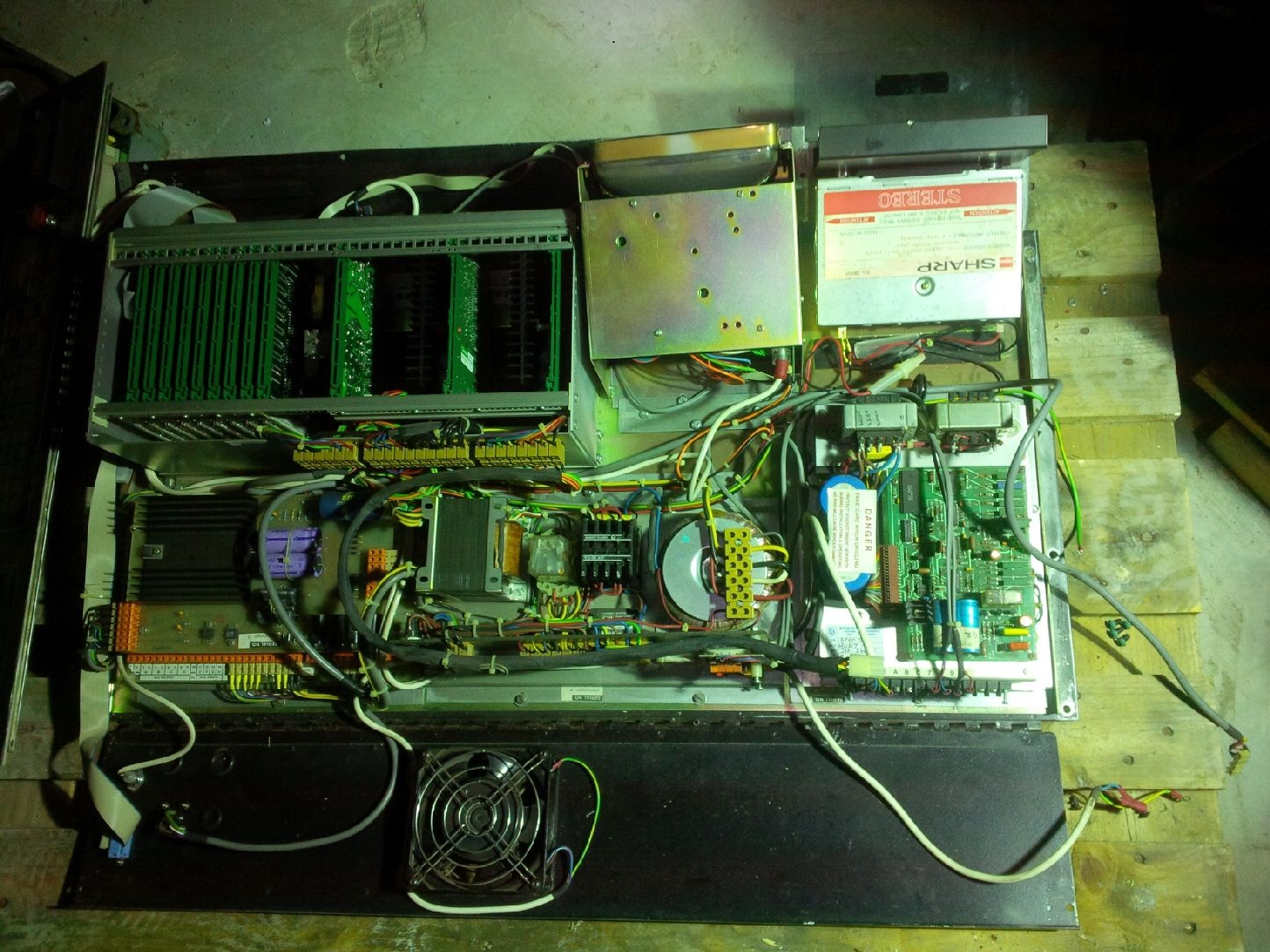

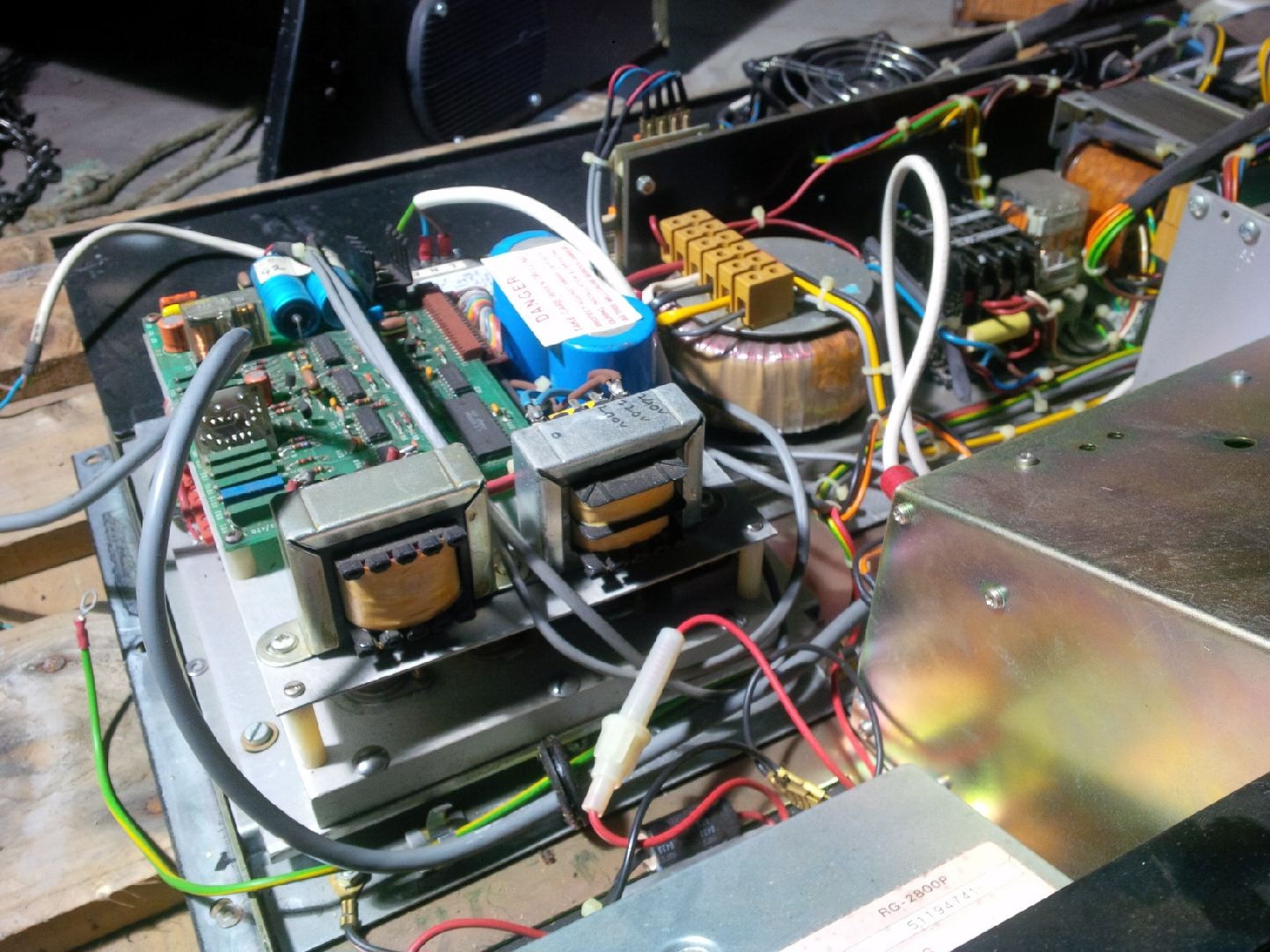

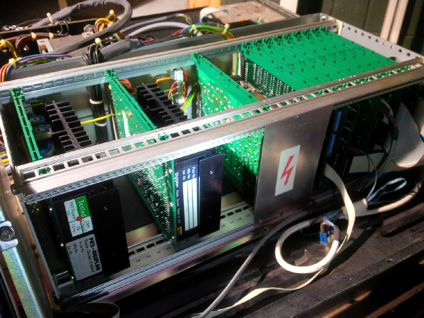

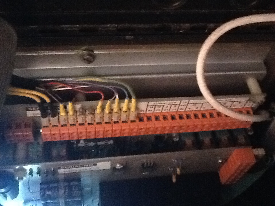

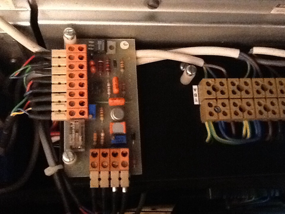

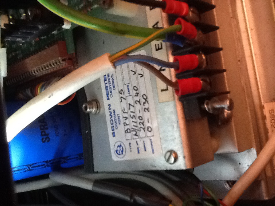

I have seperated the lathe and taken some pictures
it looks like the lower voltage orac, so the sd2/3 drivers are correct for that machine. Have you tried the reset button.

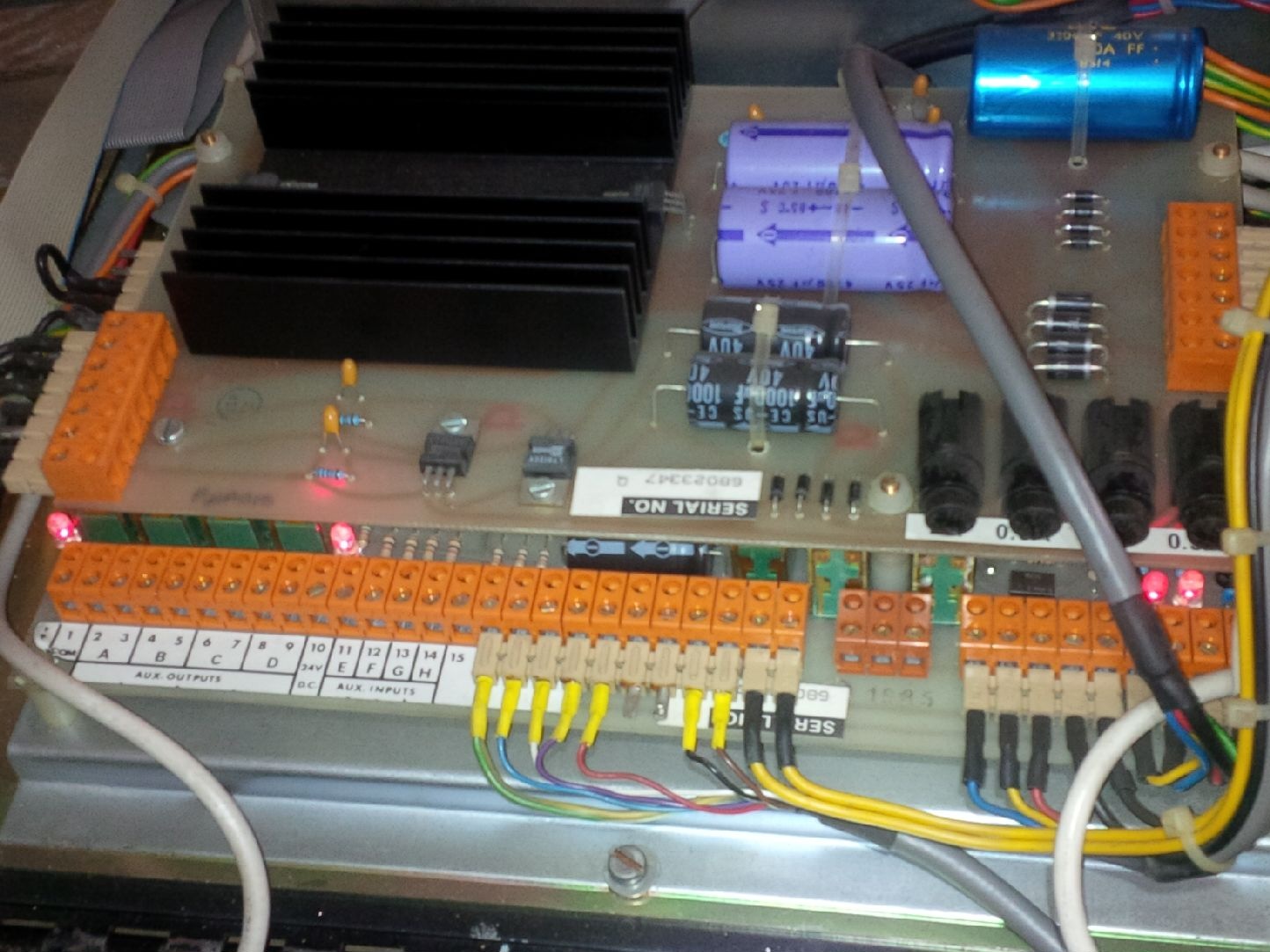

Here is a picture of four red ligths that turn on. I guess they are indicating a failure?
I don't think any of the LED's are showing faults. I presume the one on the left is either 5 or 12 volts, the one in the center is the 24 volts & the two on the right are showing the spindle encoder. If you turn the spindle by hand they should alter.
