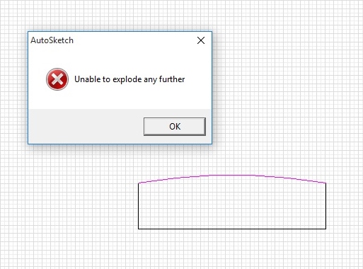

Auto Sketch can create .eps files, but I can't find a way of importing them into VR Milling. The VR Milling help file only mentions importing .dxf and .dwg files.
Auto sketch won't allow the .dxf file to be exploded.
