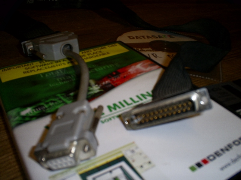

The machine is November 1993. I am in the process of trying to find a PC with 2 serial com ports which is proving difficult as I am not to clever with computers.
I have also just ordered a compressor.

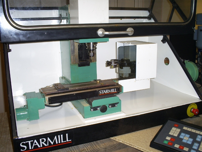

Here (hopefully) are some pics...
Mark

If you are running VRMilling version 2.31 you do not need the desk top tutor as you control it directly from the computer. Therefore you will only need 1 Com port.
Make sure you use the correct RS232 lead as the two in the second picture are not.

I have had success using USB to RS232 adapters BUT it is not guaranteed to work. I was lucky and was able to prove things worked on my machine. I changed to proper RS232 ports (lucky I kept an older motherboard with them) as I was getting the odd glitch but that may have been due to running an XP DOS window and have moved over to running a DOS box for my lathe.
As Martin says, make sure you get a proper lead. I went through a fair amount of testing until I found a wiring issue on the lead. It was a genuine Lindy lead as supplied by Denford but I think the leads changed at one point and the lead I have is a later version, it came with the machine when I bought it from a school who had been unable to get it working. Fortunately I have been playing with Computers and electronics for most of my life so was able to work it out.

Martin wrote:If you are running VRMilling version 2.31 you do not need the desk top tutor as you control it directly from the computer. Therefore you will only need 1 Com port.
Thanks for taking the time to respond chaps.
I am not overly bothered about using VR Milling software, I am hoping just to use G Code programming. Am I right in assuming that the desk top tutor is there for this purpose?
Also, the 2nd picture is both ends of the same lead which came with the machine. Again I assumed (because of the length and fitting arrangement) this to be the cable between a PC and the desk top tutor.
If I am correct (please advise) then will I need to purchase another ribbon type RS232 cable to connect the control box to the port of the PC? Where would I buy one of these please? A part number would be good to make sure I get the right one.

Lastly, the emergency stop is in and I do not have the key, guess I will need to purchase another.

VRMilling does use G & M codes. I presume it has been upgraded at some point to VRMilling which means the Tutor is obsolute.
The cable you have is a pin to pin & not a RS232 lead.

I wonder if the 25w to 9w has the required mods inside linking just the required pins to make it RS232.
The flat cable is just the same as the one that was attached to a desktop tutor a friend bought with a starmill from the same school I got my starturn from. His was also upgraded but to a USB control board so the tutor keyboard he has is also redundant.

Do you have access to a multimeter? just thinking you should test the RS232 leads to find out what pins are wired to what.
Also have a look on the inside of the black box to see what pins on the 25way are connected. I have a genuine Denford black Lindy 9pin to 25pin RS232 lead on my Starturn and had to swap the TX and RX lines over in the black box to get it to work. Probably why the school couldn't get it working years down the line.

Up and running!! many many thanks to TDIPower and Traic.
It was down to swapping the TX and RX pin connections over on the cable which came with the machine as Pete said above.
