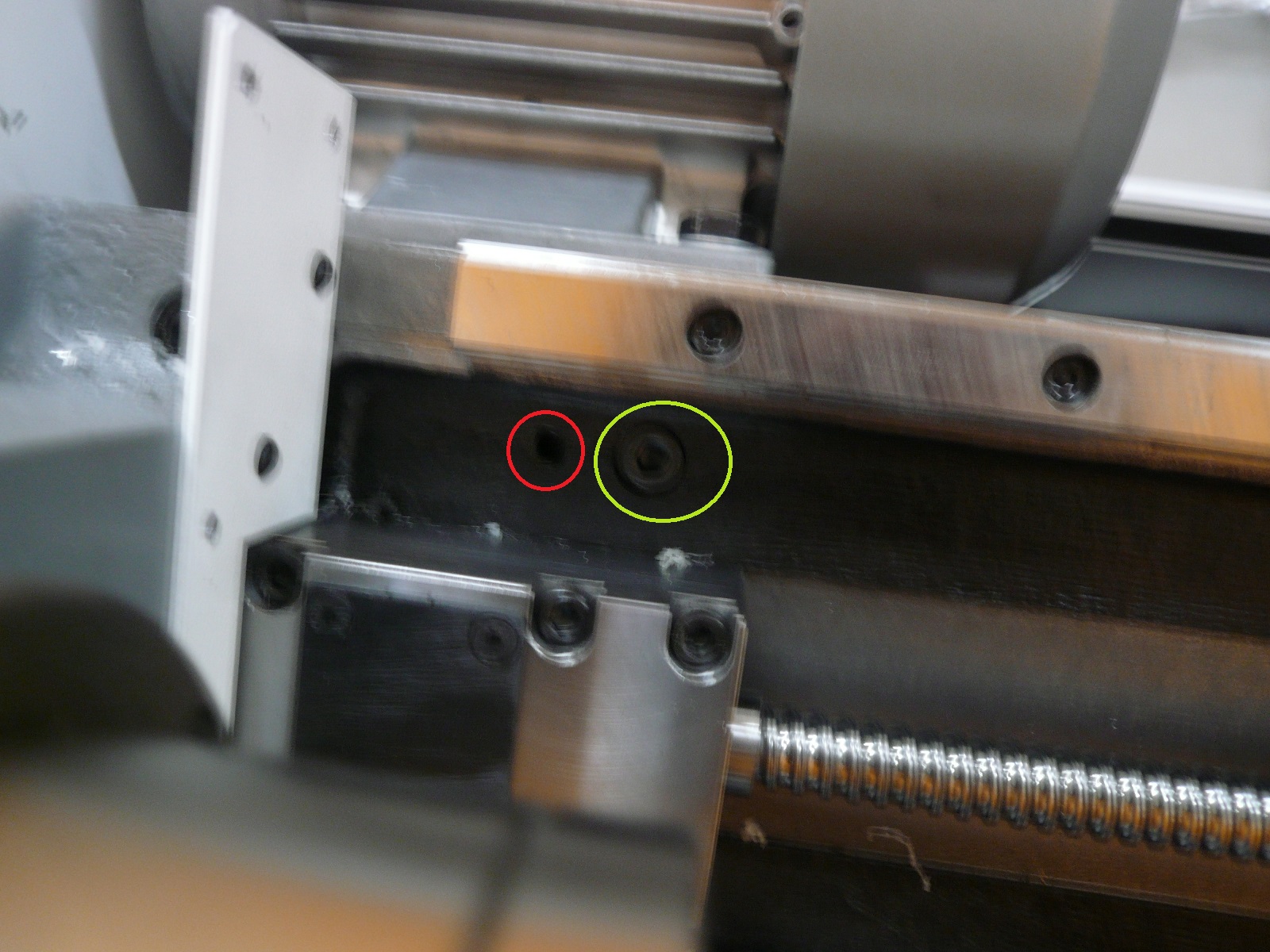

All right, I´ve striped her partially.
I´m now at the point that I´ll have to take off some more heavy casted parts.
The thing is that I´m thinking that the whole lathe could come off in one piece, if I take off the machine bed that is attatched to the two collums welded to the grey tray.
I found two screws. The allen screw goes right through the machine bed (green circle) and for my understanding keeps the lathe in place and the other one (red circle), well I got no idea what it is for. Looks to me like it is a grub screw and the thread is in the machine bed. What is it good for?
If I unscrew the 4? allen screws, will the whole lathe come off? When I put it back together, is there anything I have to adjust? Or is it all set when I put it back together?

Unfortunatelly I have to take it apart as there is no way to shift it in one piece.
The only thing I´m now wondering really is what the grub screw is for. :?: :?: :?:
Re: How to move a 270
Just asked in the factory.
The grub screw allows for fine adjustment during build. It may also have isopd between the casting & plates. If you can avoid stripping it down it would be muck easier.

Yesterday she got moved and I unfortunatelly had to take the whole bed off.
I marked the screws and will just tighten them until the lines match up. Was unfortunate but it had to be done :(
