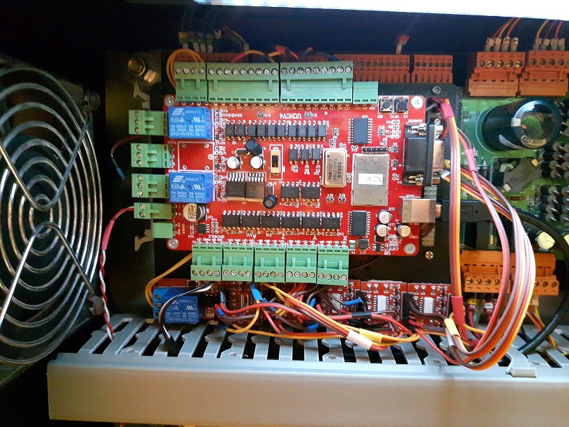

Been busy making stuff lately and forgot to come back to complete this thread, I bought a bespoke 3D printer so the Novamill is a mill again.
Here is an image of the final conversion.
The controller is a USB CNC clone, the Red daughter boards are 4 channel opto-couplers sourced from china via ebay,
They are all mounted on a 3d printed backboard that holds the 96 way connector. Almost everything goes via the header, and the safety interlocks are all present including a feed back to the card to pause the programme due to an E-stop which is achieved via the relay daughter board (bottom left).
The spindle speed control is achieved via a servo driving a POT to get the 0-10v with a 3d printed mount. This is because whilst the sprint control card used a 0-10v signal it floats at about 180v above the control ground and I couldn't figure out how to easily isolate it (after I blew the analogue signal on the control card so had to use the servo PPM output).
Hope someone finds it interesting / useful...
