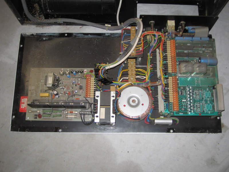

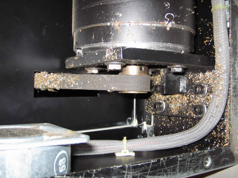

This hole that lets swarf in is a BIG PROBLEM. Just opened the bottom on mine to look at the electronics. There is swarf all over the place - including on the stepper drivers on the opposite side of the lathe to the hole! I've enclosed some pics below of the problem.
Stepper drivers are only set to run at 1.8A, not the 2A maximum of the board while the motors are 2.1A

Overall View of electronics
Electrics 001.jpg (63.99 KiB) Viewed 43276 times
Swarf falling down into electrical compartment

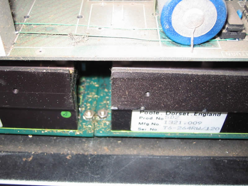

Swarf on stepper drivers below slaveboard
Electrics 021.jpg (64.85 KiB) Viewed 43276 times
The cause - this hole - the one filled with swarf - hidden by the Z axis stepper motor

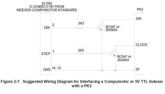

Hi Dave, You could still use your drive boards if you use opto isolators on the step and direction pins. A couple of resistors and vero board and maybe use opto isolater 1LQ74 or similar.
Hope this might help..

Now for some pics of my starturn. Firslty, my cure for the holes into the headstock - good old silcone sealant!

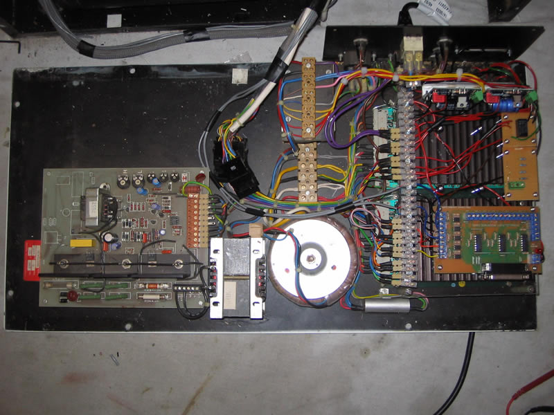

Secondly a view of the elctronics during the testing stage - I need to tidy up the wiring! This was while waiting for the transistors for the stepper interface had been fitted. The processor board has been replaced. At the bottom you have a parallel port breakout card. Middle right is the stripboard circuit for the stepper interface and above this is a small latching relay for spindle on/off using the original buttons. Above this are two AC-DC 'converters'. They take the output from the original ancillary transformer and produce 12V and 5V DC. 12V is used for the relay circuit and passes through the emergency stop button. I've broken the Estop circuit to cut out the limit and guard switches (previously they were in series with the 12V Estop circuit) - they will now be hooked into the breakout board instead. Hence the two extra screened cables you see runing down the main loom.
Thirdly - the interface circuit for the stepper drivers. The input lines to the drivers are held at +12V. Therefore you simply need to pull them down by using this circuit to make them work.

My electronics
My electronics
New Electronics 009.jpg (95.95 KiB) Viewed 42956 times
How to hook up the stepper drivers
Digiplan Interface.JPG (16.53 KiB) Viewed 42956 times

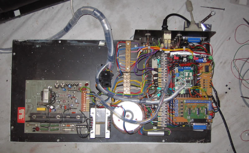

Right- thought I'd update this thread with some pictures at is largely complete.
First pic shows the electronics. On the right is where the main processor used to be. To give you aan idea of what's what on the new board -
Bottom - breakout board to isolate PC from the lathe
Middle right - lower bit of stripboard is the stepper 12V to 5v interface to allow the old drivers to be used. Above this is a latching relay to allow the old spindle on/off buttons to be used.
Middle left - Digispeed, the spindle control interface.
Top - 2 rectifiers to turn the old ac input to the control logic to 12 and 5V DC
Hidden above these are the two main relays for spindle and emergency stop.

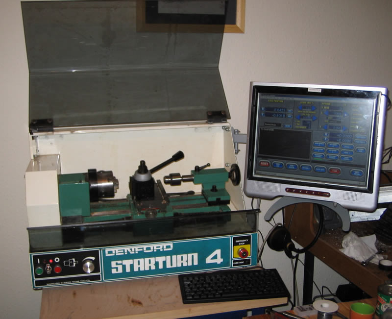

Second pic shows an overall view of the lathe.
Third pic shows Mach software complete with touchscreen (ebay bargain!!).
Hope that provides you all with some inspiration.
Dave
Yes - that is a touchscreen! I made a bezel and glued and screwed that to an exisitng montior - the glass touchscreen then slides in
Overall view of the lathe - notice the extra switch and LEDs by the original on/off switches. The switch gives auto/manual spindle control and LEDs show the status.
View of the electronics
