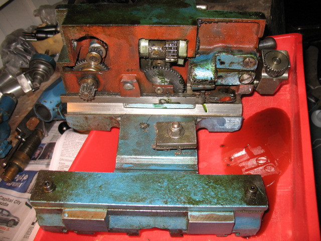

Stripping down was fairly straight forward. I just started at one end and laid everything out in the order of removal.
The only tricky part was figuring out that one hole had four set screws to hold two shafts.
The lead screw handle disengaging bar is held between the apron and the bed and slides when it hits the stop on the bed to disengage the lead screw handle. It's important to know this when reassembling.

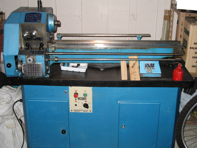

The lathe sans saddle.  Note the support block at the right end of the lead screw / feedshaft has been removed to allow the saddle to be slid off the end of the bed.
Apron, Upside down, before cleaning.
The apron and saddle up side down before stripping down.
The saddle stripped and cleaned prior to reassembly.  The saddle is held to the apron by two socket screws.

Hello! Just a quick question regarding removing the apron... How does the end bracket supporting the lead screw and power feed shaft come free of the lead screw? Do I need to remove the end retaining block from the lead screw or does it pass through whole? I think I am correct in assuming I do not have to draw the lead screw out of the gear box?
I am asking this because I need to investigate the power feed lever mechanism as it will not engage properly. Thanks.

Remove the end support on the right end of the lathe bed and simply slide the saddle off the end of the bed.
I never removed the lead shaft/feed screw. I think that requires the gearbox to be disemboweled.
