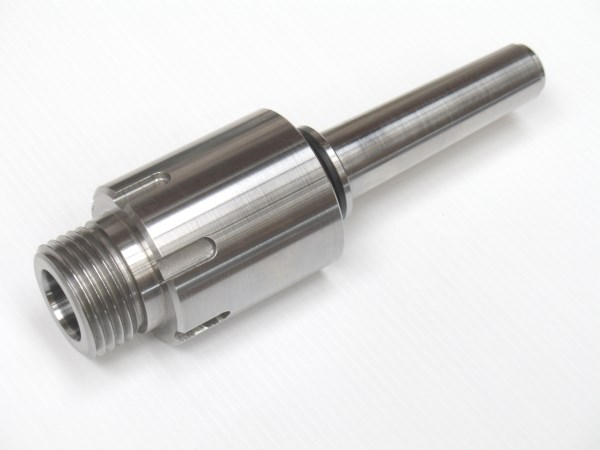

The components that make up the adapter excluding the bearings.
finished adapter 3.jpg (33.34 KiB) Viewed 22452 times

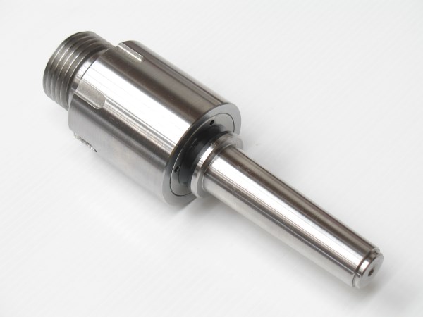

The black band in the centre is a lip seal protected from damage by a small flange.
finished adapter 2.jpg (28.69 KiB) Viewed 22452 times
The completed live MT3 spindle adapter
finished adapter 1.jpg (29.35 KiB) Viewed 22452 times
