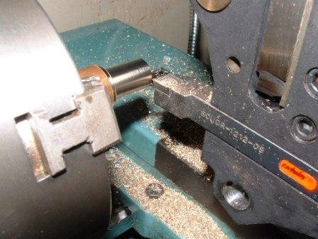

Tool Collet turnedemail.JPG (29.87 KiB) Viewed 9871 times
