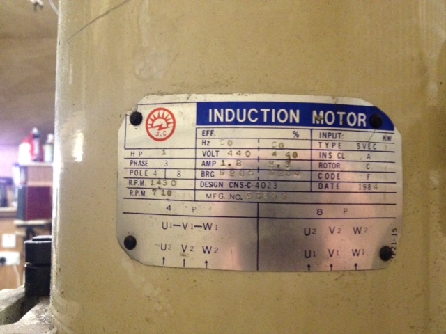

Is the spindle motor off my 1984 Easimill suitable for connection in delta and running off 220 volts through a vfd?

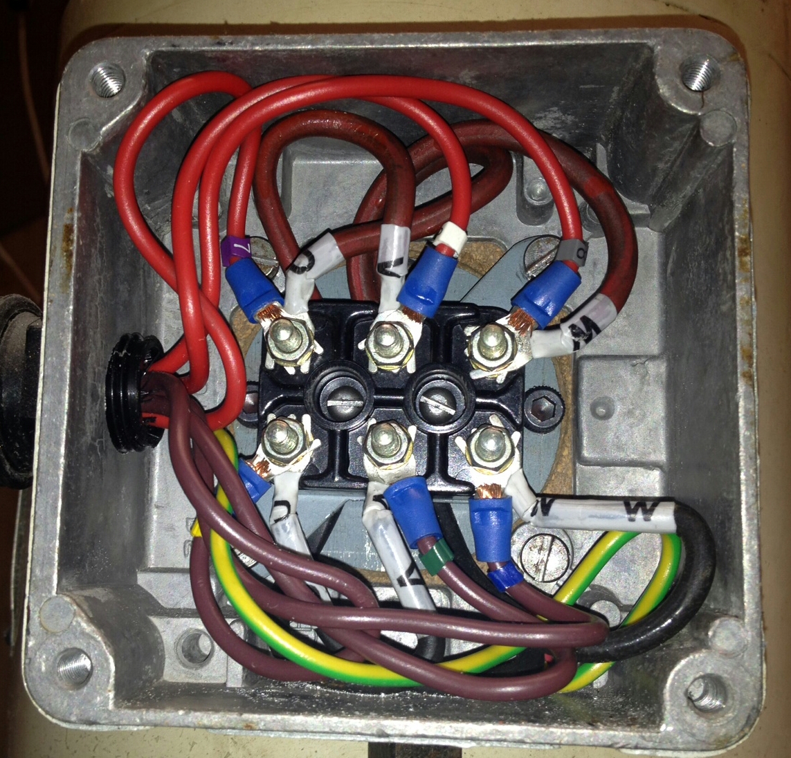

As can be seen in the photos, the name plate shows it as being 440 volts 3 phase with no mention of 220 volts. Before I took the motor off the machine there were no brass/copper straps between the U, V and W connections seen when connecting the motor in star and running off 440 volts. Another reason I'm not sure is that there is no mention of star or delta on the name plate either though there are the six terminals, labled as U, V and W as is usual with a dual voltage motor.
I've searched the net and not found anything to tell me what the connections are in a single voltage 3 phase motor, so any help would be appreciated.
Motor internal connections.
Motor connections before the motor was disconnected
Motor name plate showing 440 volts only.

All six connections to the windings have been brought out, so it should be possible to wire the motor in star or delta.
Star connection:- power to U1, V1, W1, Link U2,V2,W2.
Delta connection:- Link U1 & V2, V1 & W2, W1 & U2. power to U1, V1, W1.
However it doesn't appear to be a dual voltage motor with each winding split in two, resulting in 9 or 12 connections.

Looking at the plate, it seems to be a two speed motor where the speed depends on whether the motor is connected in star or delta.
For some reason the straps for delta connection don't appear to be shown.

Looking at the wiring diagram for the Easymill, it uses external star/delta switching for the spindle motor. This enables the high and low speed ranges to be selected. That accounts for there being six wires going to the motor rather than three and no brass straps.

So am I right with the following?
A) The motor will run 1430 rpm when connected to 440 volts in star.
B) It will run at 710 rpm when connected to 440 volts in delta.
C) It won't run usefully, if at all from 220 volts when connected in either star or delta through a VFD.

When HIGH speed is selected contactors C1 and C2 are operated connecting the motor in delta.
When LOW speed is selected only contactor C3 is operated. This contacts the phases to U1, V1 and W1, there being no connection to U2, V2 and V3. I cannot see how this will make the motor run unless the motor has internal connections which are not shown. These connections do match those shown on the maker's plate on the motor though. They also appear to match the slip speeds to be expected from 4 and 8 pole motors.
Without knowing the internal connections of the motor I cannot tell you whether is can be powered from a VFD.

The motor appears to be switchable between 4 and 8 poles, something I've not come across before. Internal and external wiring is probably as shown in this link:-
https://www.elprom-gem.com/en/specials/t ... motors.pdf.
The lower set of diagrams are applicable to 4/8 pole motors.
Looking here, a dual pole/dual pole motor cannot be used with an inverter (VFD).
https://www.powercaps.co.uk/wp-content/u ... -Guide.pdf.
It looks like you'll have to use a rotary or static convertor if you want to retain the two speed function,
To use a VFD you'll need to fit a dual voltage motor, which will enable you to vary the motor speed.

By all means try it, but remember that because of the way this motor is wired internally you'll need to connect the phase wires from your VFD to U1, V1 and W1 with no straps.
