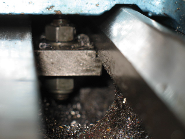

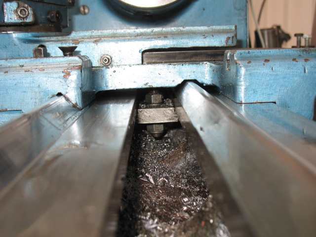

The length is not critical but it is close to being a square. The piece is shown in this photo.
An overall view of the anti-lift piece located under the apron.
A close up of the metal piece. Note the step in the side.
