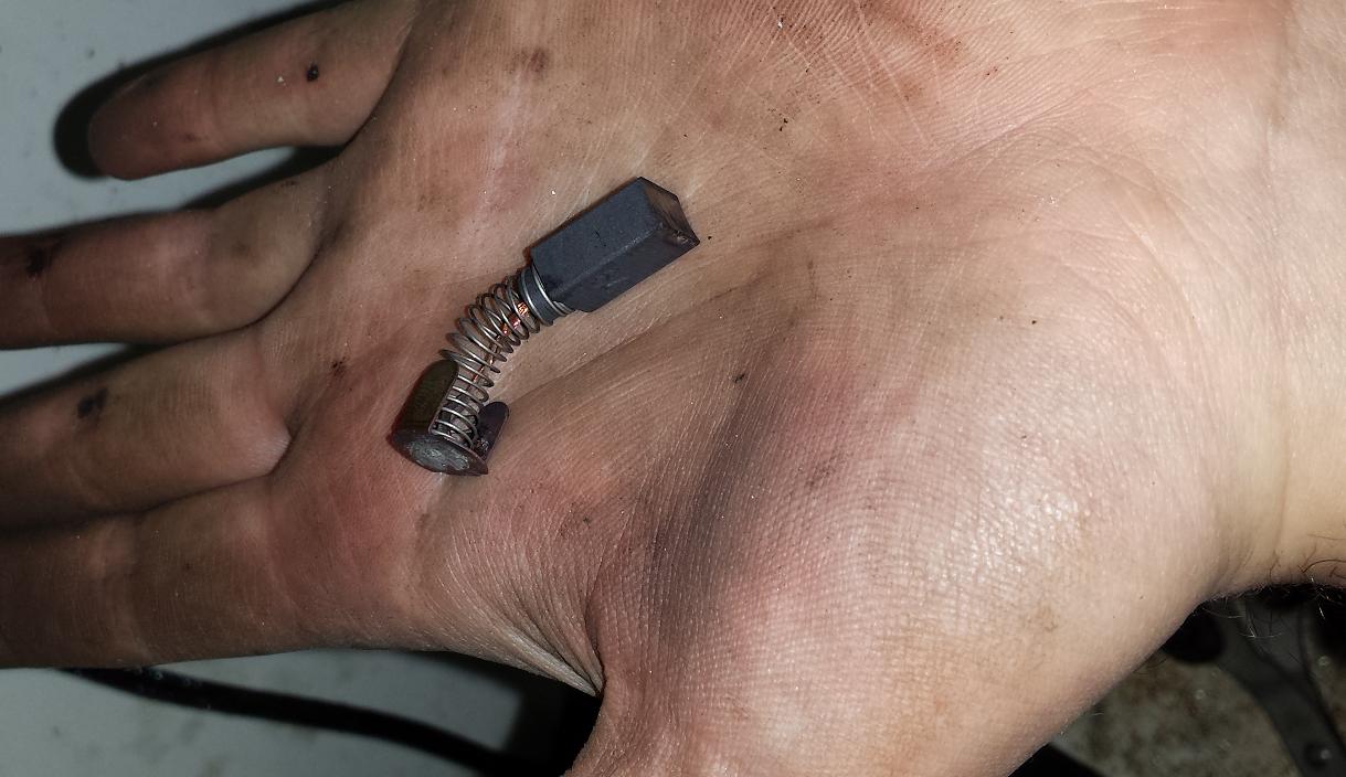

After finally managing to remove the motor, I pulled the brushes out to inspect them.
To be honest, I'm not really sure what a good brush or a worn one should look like.
Does anyone have any idea whether or not these brushes look any good or not?
Re: Spindle Motor Problems
they don't look too bad, were they sticky to get out or did they slide out easily?
They look like new. I presume the spindle is free to turn by hand?

Thanks both. Although I don't have a lot of experience to go on, I thought they looked OK too.
They certainly came out pretty easily and yes, the spindle turns by hand. I replaced the bearings in it earlier in the year so I know they're good too.

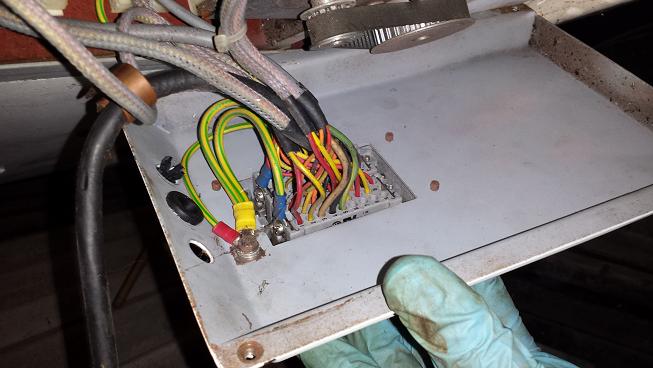

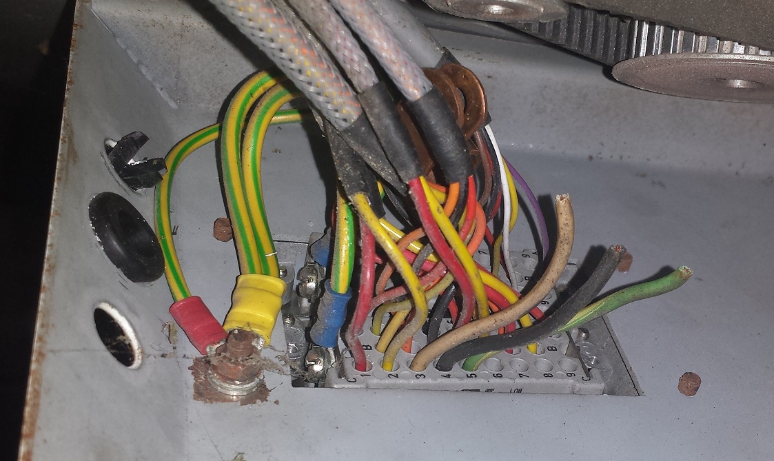

One question though, the attached picture shows the wiring into the connector block on the back of the machine.
Does anyone know if it's possible to remove the wires from the connector block or will I simply have to cut them?
Many thanks
You need a pin extractor to remove from the barring plug.

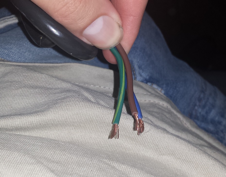

The wires on the old motor were:
Pin3 - Brown
Pin4 - Black
Pin5 - Green/Yellow
The wires on the new motor are:
Brown
Blue
Green/Yellow
Am I right in thinking that the new wires should go:
Pin3 - Brown?
Pin4 - Blue?
Pin5 - Green/Yellow?
Thanks!
