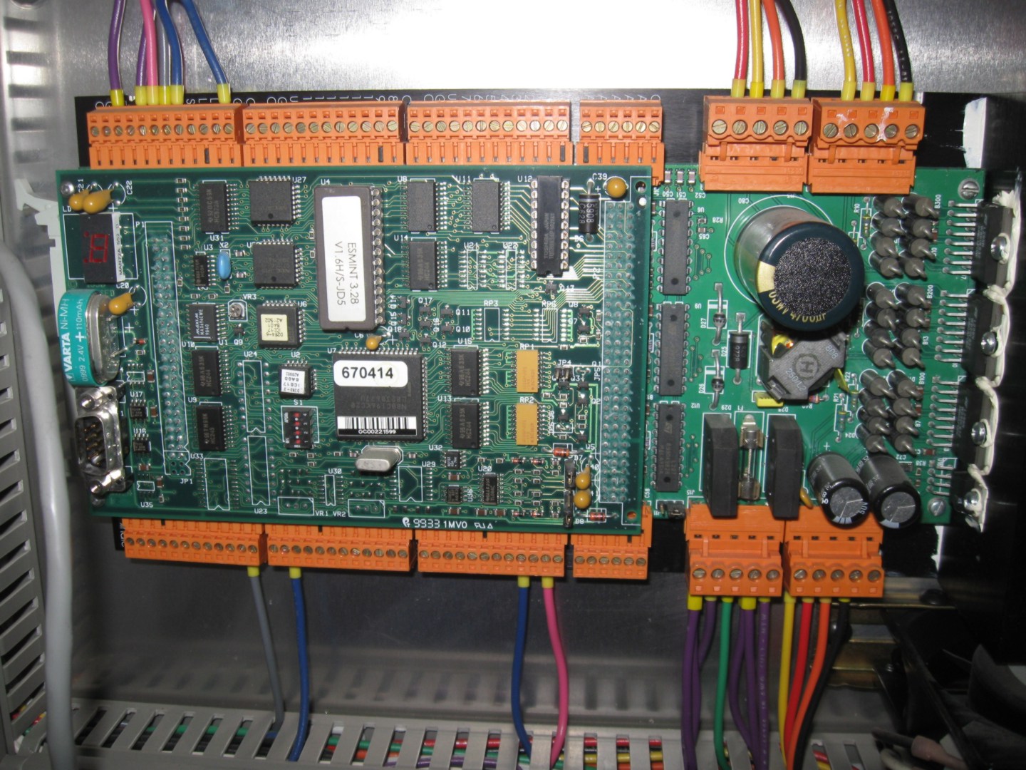

Not sure what I have is called, but here's a picture.
Did not get any flicker at all from the 7 segment LED when powering up or powering down.
Re: New Owner Mint3.28 hang up
It's a NextStep.

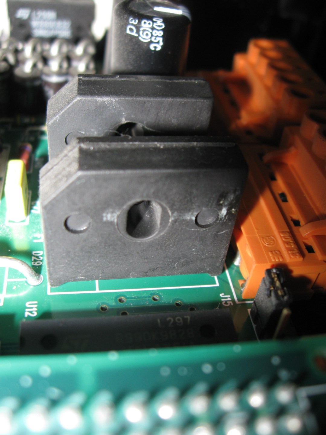

From what I've seen, it's looking like the two big rectifiers on the Baldor board are fried.
Would like to verify, but I think the KBU8D rectifiers are pretty much toasted, as I dont have +5 +12 -12 volts.
So what kind of challenge is it to replace the rectifiers?
How do the Orange conenctors come off the board?
Do I need to do anything with the drive transistors on the big heatsink? Or will I have access to the underside of the PCB to remove the Diodes?
What could have toasted them? A spindle crash? This machine was used in a high school.

Got the Baldor board out, easier than I thought
From what I'm piecing together, the Spindle drive is a small pc board that sits above the transformer.

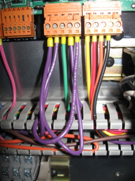

Looks like there is a jumper (blue wire) between TB1-6 and TB1-2 (Stop and Grnd)
Looks like I have some type of mutation between smartstep and next step.
Could the blue jumper between stop and ground be causing my problem?
i.e. was in school, previous instructor put a jumper on it so kids don't mess around,,, I dunno, can't seem to find any one schematic that fits what I got.
Looks more like a Denstep, with 24VAC supplied for both drives and logic.
And from looking at the Denstep schematic, looks like the E stop cuts power to the Xformer
I have 24VAC, so it's not a bad E stop button.
Since the logic doesn't like 24VAC, (as per an earlier post) is there a "fix" I can do to give it DC without messing with the PCB or replacing the transformer?
Or should it work fine the way it is,,, well wait a minute, it's not working at the moment,,,

Back with another stupid question,,, the keyswitch, is it momentary, or On/Off?
I don't have a key and hard wired the two orange wires together.
After some serious investigating (and reading the user's manual) I've determined that the key switch is a momentary switch.
So I'm thinking, maybe, cross my fingers, maybe, tying the two orange key switch wires together, might have preveneted Voltages.
I put the entire thing back together (had the Baldor board removed to change the Rectifiers, which look suspect, but not 100% positive) smae problem, no 7 segment display.
Back to bad diodes,,, but could me tying the two orange wires together have fried the diodes? I think unlikely.

Removed the bridge rectifiers, but they test good,,,
What's the most likely issue pulling the +12 and +5 volts down?
What could pull both voltages down?
