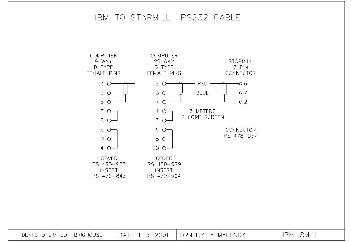

The manual for the NEE SMCU Starmill shows the pin outs for the RS232 port.

Re: RS232 wire end
Starmill RS232 Cable.

Hi Again,
Am I reading your drg. wrong.
I have 4 wires red, black, white ,yellow. which come from
the rs232.
I can only see red and blue on your drg
could you put me right in laymans terms.

Re: RS232 wire end
All the NEE drawings I can see just have the two wires.
Can you look at the other side of the 7 way socket in the electrical box & check if it has 2 or 4 wires.

Re: RS232 wire end
It looks as though the internal lead is only 2 + a earth (Shield) so you should be able to check the 25 way D type end & compare it to the drawing above & cut out the other 2 wires.

Thanks for your help Martin,
I have finely made a correct 25 /7 (i hope) wire with
your drg.
My next step is to try it.
