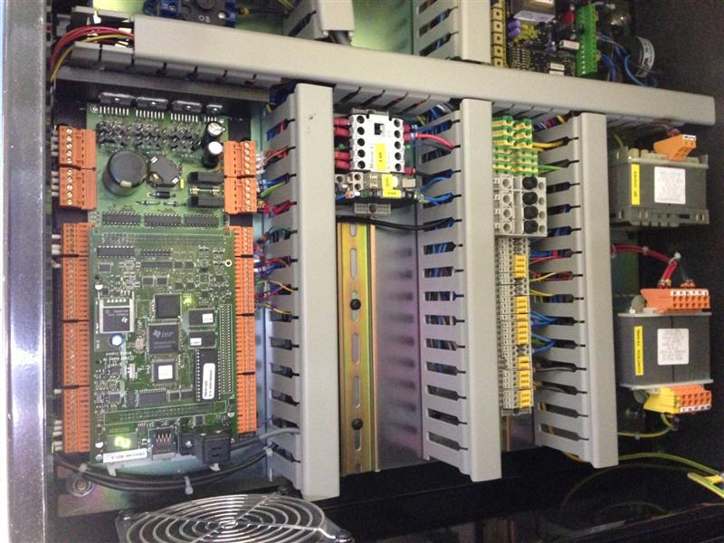

What colour is the seven segment led on the control card?
Re: Invalid Platform Code

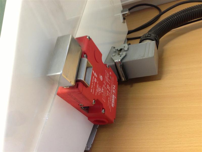

Martin, the 7-segment display is green
I have added some photos which may be of help

Have you updated the Baldor Control card?
You can update it by running EasyUpgrader which is on the VRMilling 5 CD or download it from the Denford website.
Tried running the Easy Upgrader but it thinks we have the current version.
We get an error message saying "Your card is not compatible with the very latest software"
Bootloader is out of date and cannot be updated. Please contact Denford........
Firmware: 5035
FCGA: 14
CPLD:9
Node:2
Out of curiosity I tired running it as a NovaMill PRO. Which had the control Type set to 9 in Machine Parameters and it worked! It allowed me to connect and jog the bed, although it get stopping as I guess its feed rates are set higher, 2000 instead of 200 in parameters.
