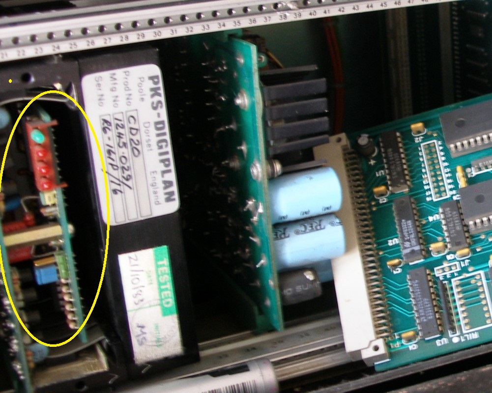

Has anyone got a spare Digiplan CD20 driver board for my 1983 ORAC lathe? I would like to keep it in its original condition.

his drive has the four leds on one end.
Re: ORAC CNC lathe
IS THIS THE ONE?
Re: ORAC CNC lathe
...Can you see any of the leds illuminated? If it looks dead you have no choices but to do the following...
The drive consists of two levels/2 boards the one carrying the leds on top of the base board or mother board.
Try to remove the top aluminium heat sink held in place by 6 philips screws.
Then, remove the additional two screws from the board with the leds and gently pull this off to separate it from mother board.
Now do the same with the good drive and first swap the led boards(they are interchangeable /absolutely equal circuits.)
Maybe now you are about to notice that the good drive is out of order. This means the faulty board is the one carrying the leds.
Otherwise the fault is located at the lower board. The one with the power transistors.
Now that you know which board has failed make a visual check with the aid of a magnifying loop x30 and search for any blown capacitors or diodes, transistors etc even for broken coper traces on the underside . If you see nothing, take a multimeter and test all diodes and transistors. If no results yet you should start removing integrated circuits very carefully until you see the board resembling the one at the attached image. For an operation like this you need a low wattage soldering iron and blow air when the solder is in liquid state to completely remove solder.Desoldering pump is not good here.If you can now move the IC with your fingers it means you can remove it. But if force is needed to do this and you continue, you are about to destroy some of the coper traces on the component side under the IC you are working with.

The boards I have are the same as that shown in the photograph. The label shows:
Prod. No. CD20
Mfg. no. 1245-029
Serial no. R3-957P/47
The Tested label shows 4.4.84 so I assume that this board has been repaired previously.
I have separated the two boards and checked for dry joints and visibly damaged components. I re-soldered joints which looked suspect particularly a couple on the driver transistors. Unfortunately this did not cure the fault so I would appreciate help from someone who has dealt with these boards previously. I can send the board and will pay repair costs and post packing etc. Please advice address etc.

Please swap the top boards and attach the faulty driver board first onto the good one's socket. Do not reassemble the bulcky heat sink yet. Only screw in the 2 philips screws to secure the board in its natural position and establish perfect contact. Insert the drives in their respective sockets on the rack and power up.
We must first know on which board is the trouble..Tell me which l.e.d.'s are glowing.If possible send an image of what you see.
Please remember to swap X and Z axes as well.

Thanks I'll do this swap and let you know the result. Of the four LED's that are mounted vertically the top one is green (not on) - it is the second LED from the top that is on when the machine is powered up. Yes I do have a compressor!

I have identified that it is the smaller board that is faulty - the one which is mainly populated with 4000 series chips. There are no visible faults. Could you please advise a procedure from identifying faulty components - or - is a case of trial and error. Are you aware of any particular chip which is prone to going faulty?
