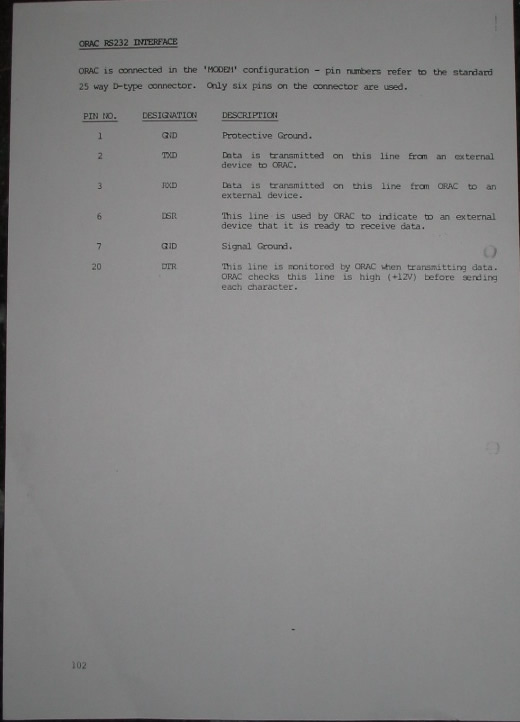

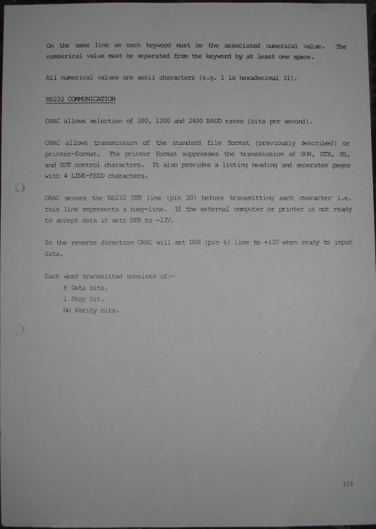

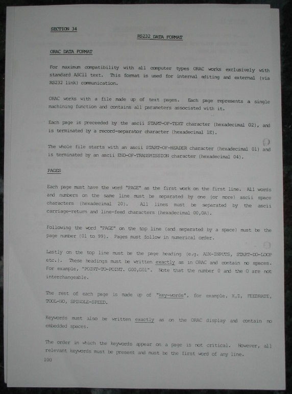

I have written a template converter/nc creator for the orac to use with EDGECam, and all is good, the code generated works perfect, if i enter it manually into the the ORAC, but fails to work when i send it via the serial port.
The setup is fine, and i can both send and recieve files to the ORAC over the serial cable.
I believe that the problem is the control characters, in the manual im sure it said that a program has to start with a control character, then each block starts, and ends with a control character, then the program ends with a control character.
I no longer have the manual for the orac, so can anyone tell me what control characters i need to use, i believe they are STX RS EOF and something else, but the orac rejects the program, so if someone could fill in the blanks that be great.

I think this is what your looking for?
Dave
Orac Manual P100
Orac Manual P100
Orac 100.JPG (84.26 KiB) Viewed 9811 times
Orac Manual P101
Orac Manual P101
Orac 101.JPG (46.75 KiB) Viewed 9811 times
Orac Manual P102
Orac Manual P102
Orac 102.JPG (45.56 KiB) Viewed 9811 times
