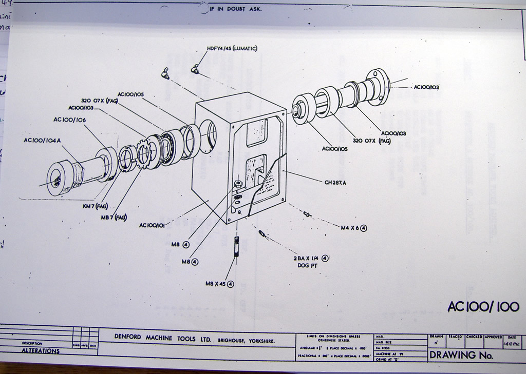

Maybe this will help ???
Orac Headstock and spindle assembly drawing

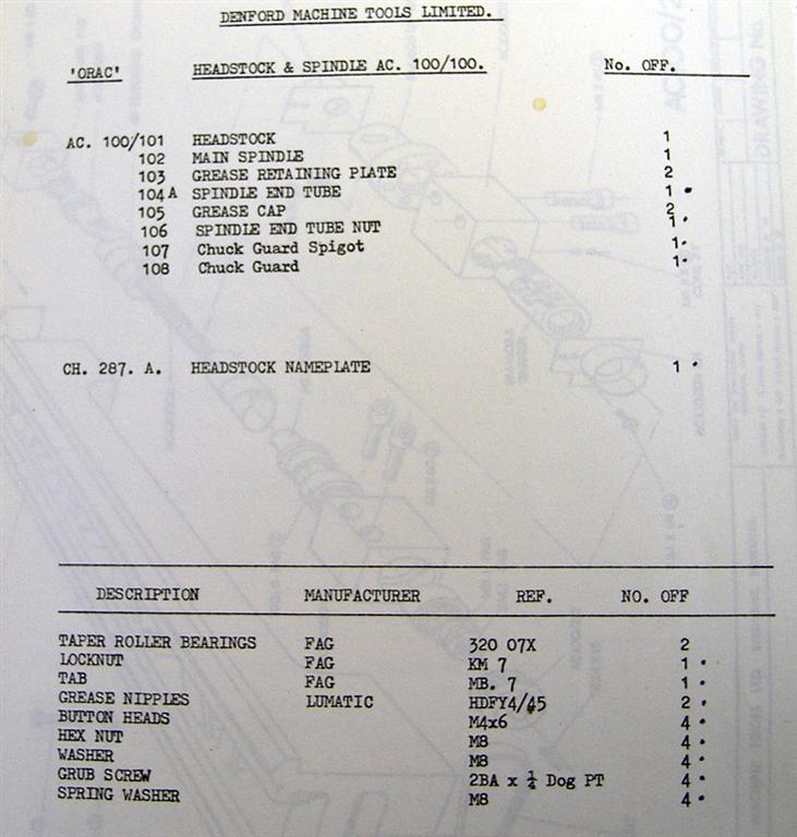

Orac Headstock and spindle assembly parts list
Denford admin beat me to it - I've got a copy of the same manual here - actually came from Denford about 4 years ago!
