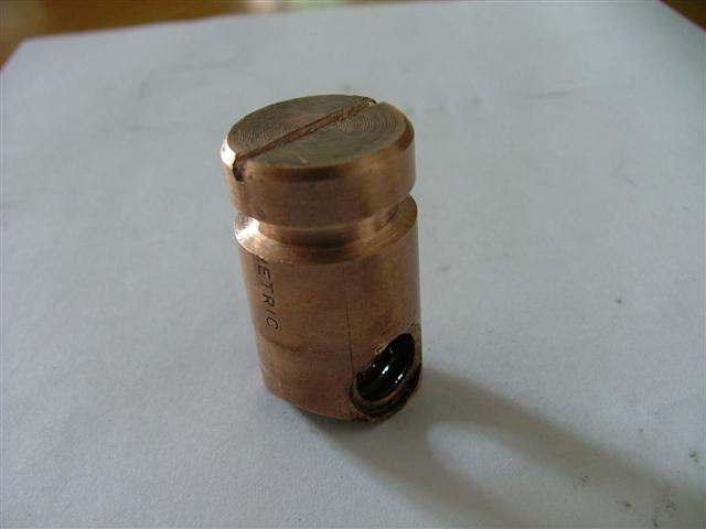

Hello to you all,
The top slide on my TDS/PCS lathe had a backlash in excess of 0.4mm. However to reduce this backlash the following mods were done to allow re-positioning of the nut by machining a grub screw groove all the way round the nut on the centre line of the clamp grub screw and a screw driver slot in the base to allow rotary adjustment (See Photo).
By rotating the nut against the top-slide lead screw then tightening the clamp grub screw any backlash can be removed and or minimized. Your comments on the suitability of this mod would be appreciated.

I have recently remove all ( 0.something backlash) by 'tinning' the threads. It worked better that I expected as backlash before was 0.7!
