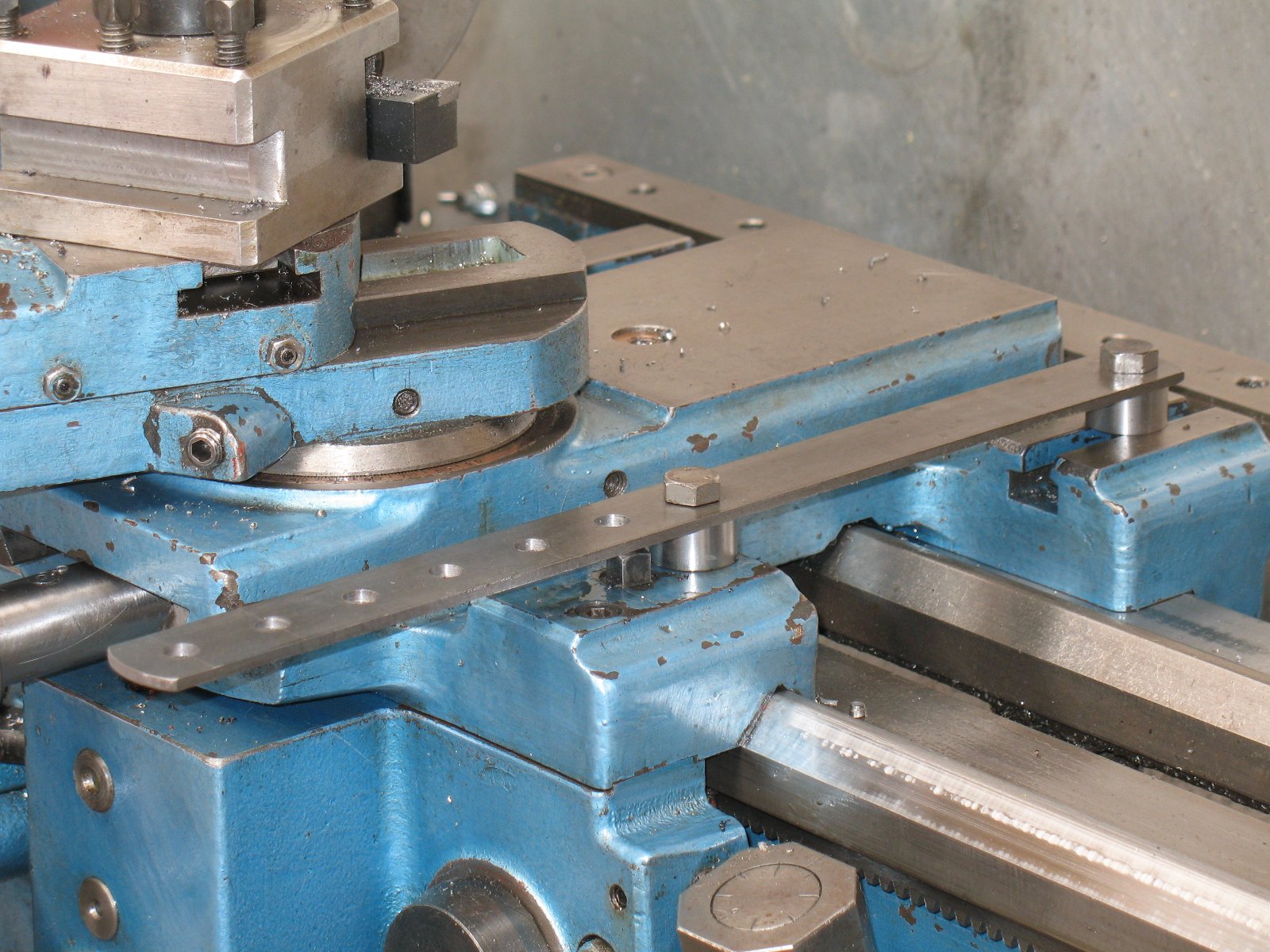

Shows how the bar that holds the template is fastened to the lathe.
Photo 5 template bar.jpg (348.45 KiB) Viewed 25040 times

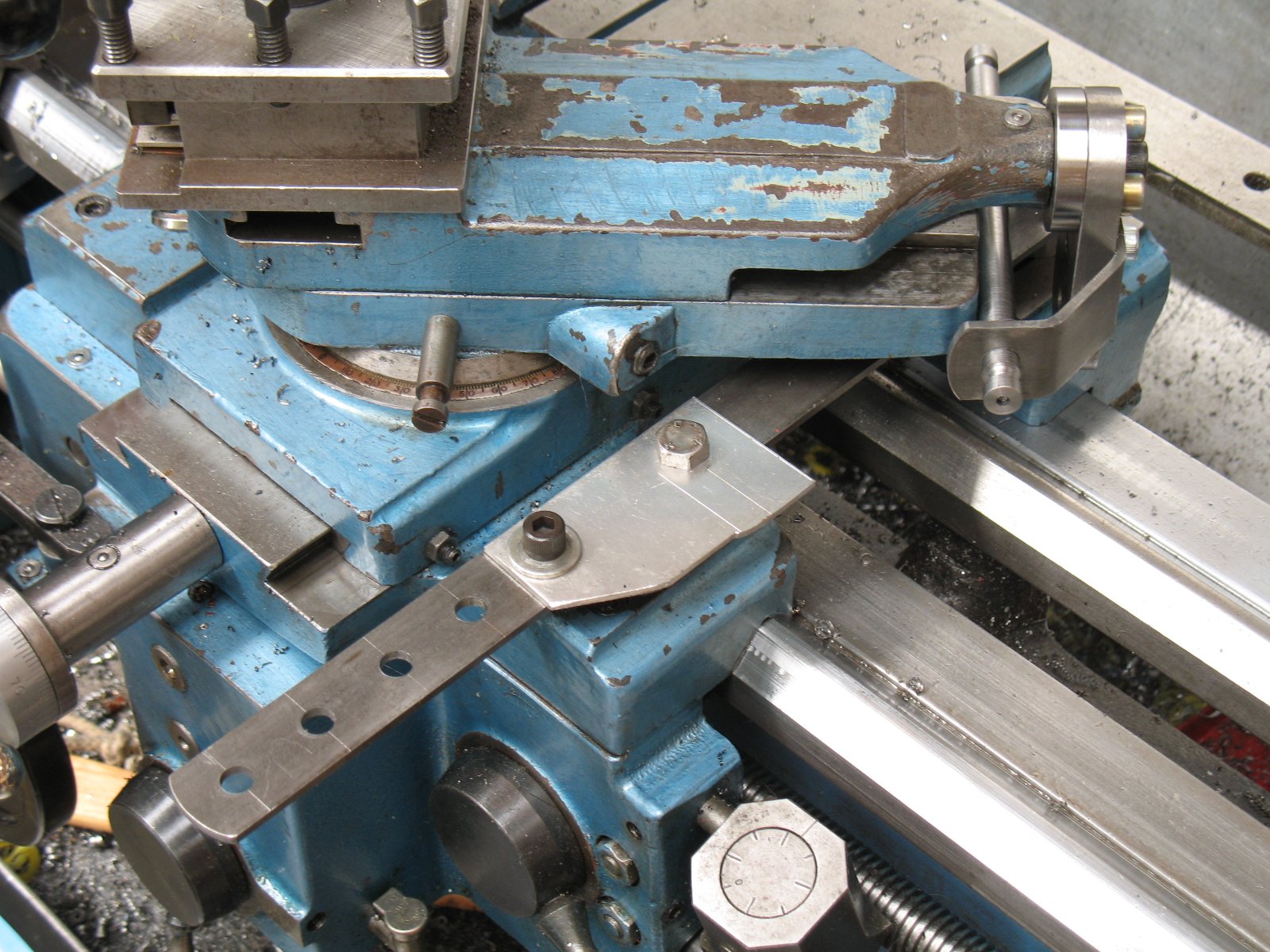

The top slide rotated away to show a template in place.
Photo 9.jpg (357.08 KiB) Viewed 25040 times

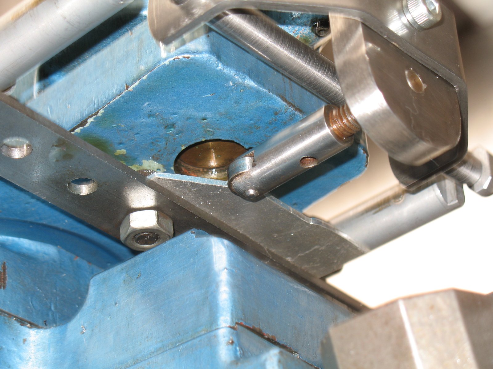

A template is bolted to a drilled flat bar and the roller follower controls the tool path.
Photo 10 stylus following the template.jpg (281.43 KiB) Viewed 25040 times
