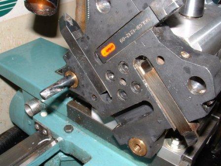

Here also some pictures of a 8 tool turret unit made for use on an Orac.
https://www.flickr.com//photos/xpylonrac ... 5602/show/
Rgds, Emgee

Hi Luke
Thought you may be the same person, only issue with tool clearance is when forward facing tools like the boring bar fitted are indexed next to the side cutting tool in use, care needed that when close to the chuck work takes place the boring bar doesn't collide with the chuck or jaws.
The toolplate dimensions I used were from a lathe using a 3" chuck, my Orac has a 4" chuck fitted which increases the risk of collision. If the work does not need the boring tool it is a simple 2 screws to undo and remove, no clearance issues then.
The same problem will be present with the original toolplate with a 4" chuck fitted, the tools need to be at a greater PCD to improve the design, you can see in one of my pictures it is possible to increase the tool PCD without issues with the cross slide.
Rgds, Emgee
