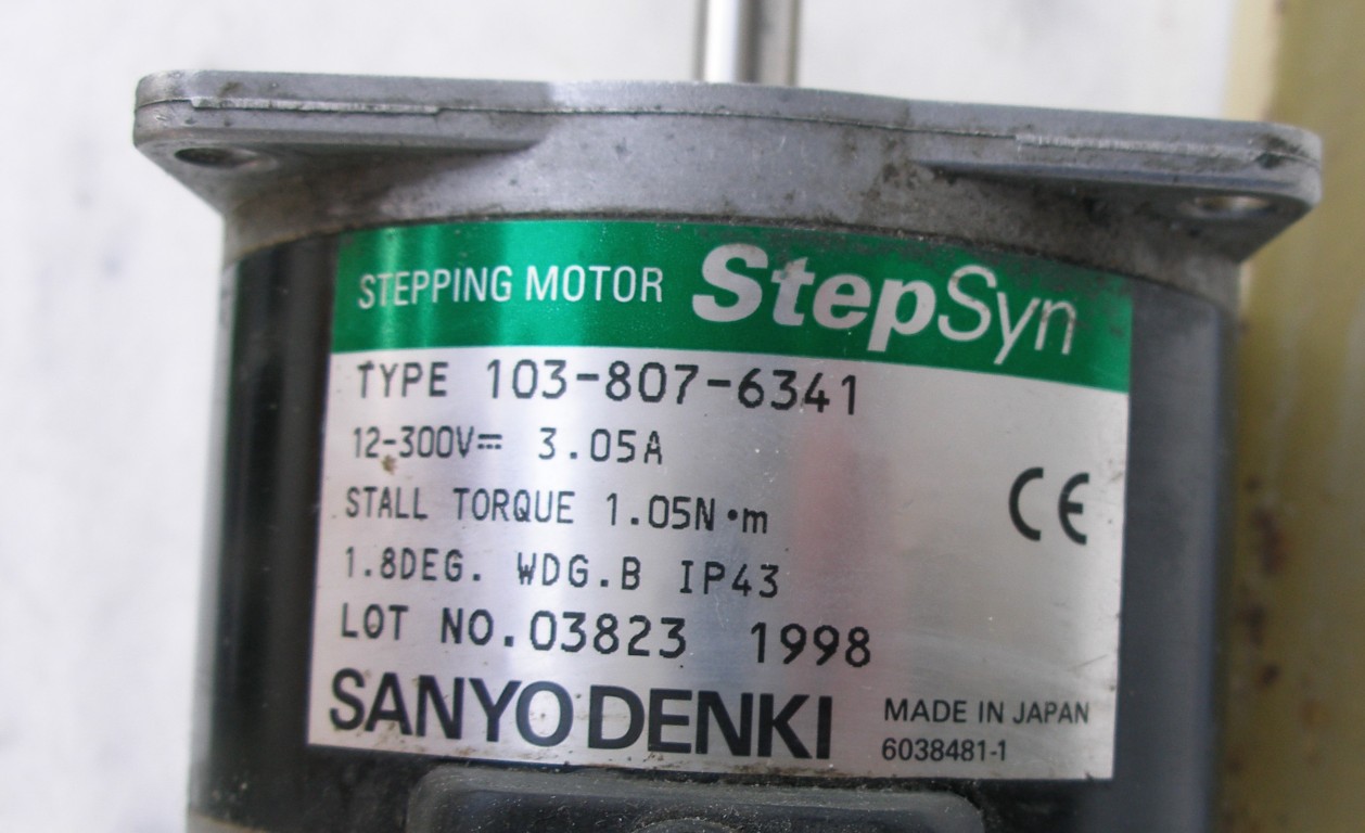

Last night I replaced the 30 year old stepper with the one seen in the attached image...With the StepSyn steppers this Orac worked non stop for 5 years 4 to 6 hours a day...
