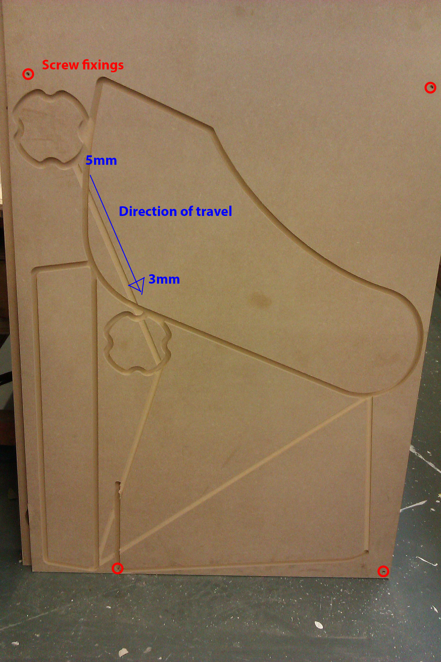

We have a 25mm MDF sacrificial board mounted to the T slots in the machine bed with bolts and the 18mm MDF workpiece is screwed directly to it. I'm not entirely convinced that there would be that amount of flex in the 18mm board especially where it is close to the screws....having said that, on closer inspection the depth of the 'cut' does vary from around 5mm at the beginning of the movement to more like 3mm before plunging for the next cut which suggests to me that the tool is not coming up quickly enough before movement commences.
I have (hopefully) attached an image to help convey the scale i,m working at the board is 800 x 1220 x 18mm
does this shed any more light on things?

From that image I'd have to say that the Z0 / datum position is set wrongly somehow.
If you jog the axes to the centre of the board and down to Z0.000, where is the end of the cutter ? It should be just touching the board.
Maybe the tool is loose in the collet and has pushed out ?
I'd look at the post-file settings anyway and see what the safe height is set to. Increasing it will help it clear the board
