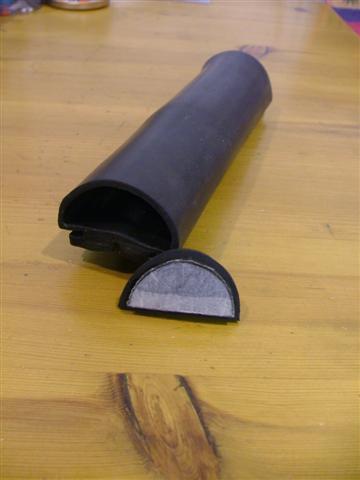

Another issue is the cabinet acting as a sounding bell; this cabinet has been lined with sound deadening material but a stiffening angle iron has been added along the cabinet door opening side to reduce vibration. Photos can be provided at later date.

I have purpose made sound absorbent material (vinyl loaded with barium oxide) but I haven't got around to applying it.

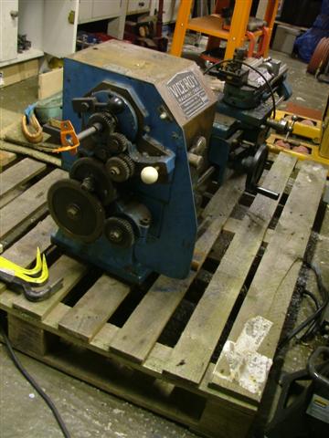

Here are a few photos of the viceroy TDS 1/2PCS (converted to single phase with a 1hp GEC motor & a Dewhurst reversing switch) lathe that is the aforementioned for rebuild plus the work done so far on the cabinet that was well rusted and has been stripped back to the base metal and primed.
Dazz, is the saddle selection lever you mentioned that selects the saddle power feed and the cross slide power feed in photo DSCF1326.jpg?

Viceroy TDS 1/2PCS lathe as delivered

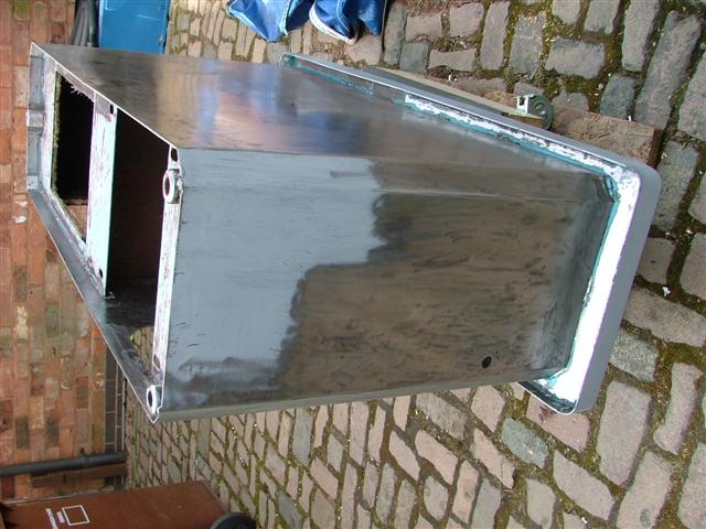

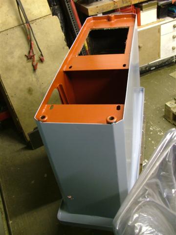

Lathe cabinet restoration to primed state, note slotted motor base plate holes modification to allow better pulley alignment.

Yes, you have powered cross feed. Not a feature you would expect to see on a stripped down basic model.
While you have the cabinet stripped to bare metal, you should check/redo the welds. If yours is like mine the welding is not that good.

Here is some updates to the renovation work to date with photos. The lathe cabinet is now fully restored and painted. The paint used is a 2 part epoxy marine quality paint by Sigma coating (Ral 5009 colour)and is not quite the same shade of blue as originally used by Denford. The finish is is satin finish and has been applied by a foam roller for gloss paints so has a dimpled effect That I hope is most durable.

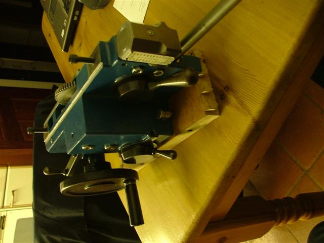

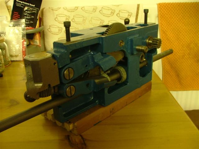

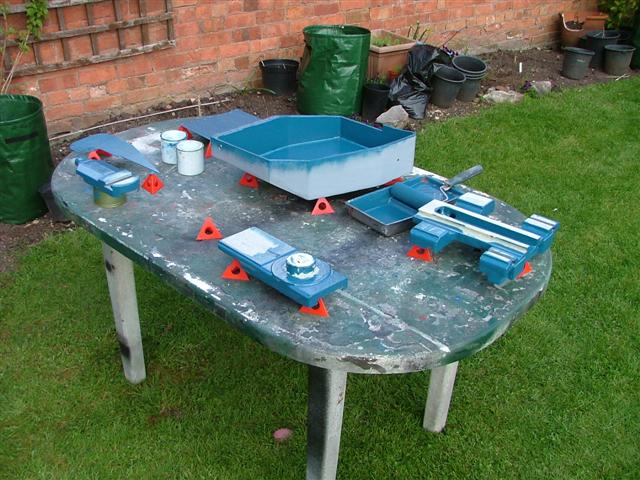

Renovation of Saddle & Other Parts
SaddleCrossSlide (Small).jpg (77.82 KiB) Viewed 28669 times
Renovated Carriage Controls
RenovatedCarriage01 (Small).JPG (44.59 KiB) Viewed 28669 times
Renovated Carriage Gear
RenovatedCarriage02 (Small).JPG (45.83 KiB) Viewed 28669 times

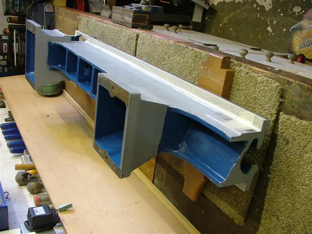

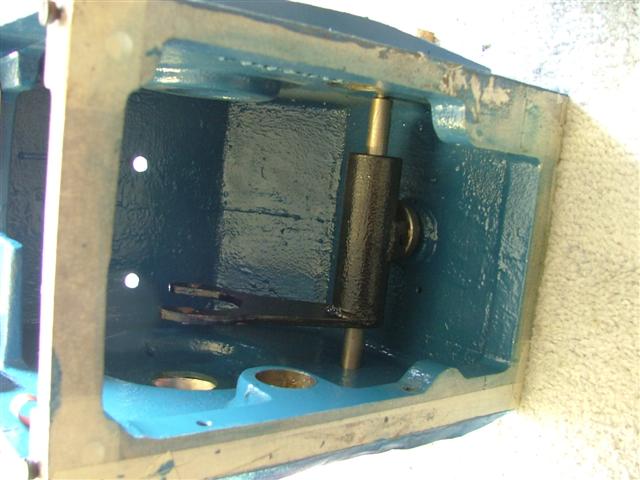

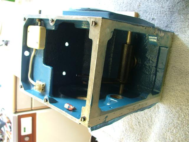

Lathe Bed Internals painted
LatheBedPartPaint (Small).jpg (61.62 KiB) Viewed 28669 times

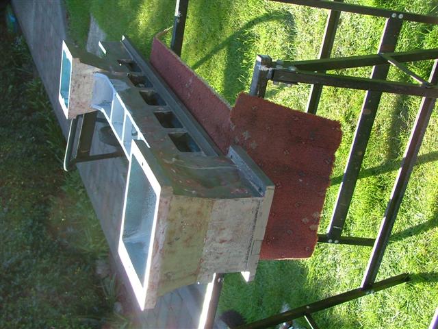

Lathe Bed Prep for Painting
LatheBedPrep (Small).jpg (77.82 KiB) Viewed 28669 times

The latest update on the rebuild is that the lathe bed painting has now been completed and has been fixed and leveled on the lathe cabinet. Leveling was achieved using a 10inch precision engineers level taking note of comments made by Dazz.
The tail-stock and feed gearbox renovation has also been completed and the saddle re-assembled and mounted on the bed. I have spare saddle clamp should anyone be in need of one, please PM me if that is the case.

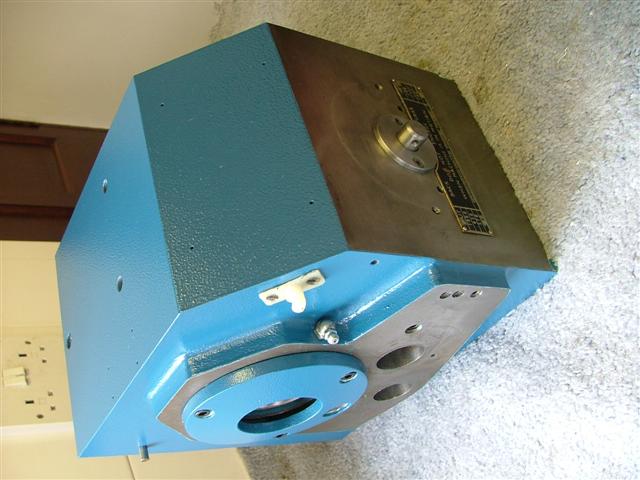

Here are some more photos that might to be of interest; this time the headstock renovation showing the freed off gear speed selector & the rewired gear cover trip.
The lathe renovation is now complete and I have a working lathe. Will post some other photos of the restored lathe at a later date.

Headstock Externals off the Lathe
Headstock Internals Without the Gearing

However, for the benefit of other members, I used a 4 inch (100mm foam roller). You have to make sure the foam type is solvent resistant otherwise the roller tends to disintegrate while you are painting. This is shown up by small parts of the roller coming away and ending up as coloured foam lumps on your painted surface.
A 1 inch (25mm) flat camel haired modellers brush was used to get into the corners/touch up the paint where the roller could not reach.
The paint used was Sigmacover 640 (has to be thinned by about 15% once the epoxy paint is mixed to be able to be used with a roller in my experience) and a metal etch primer was used as all the surfaces where brought back down to the bare metal prior to painting. I used open weave nylon type rotary abrasive discs on an angle grinder for the base and small sized discs of the same type on a die grinder and finally Scrotchbright pads to get into the corners. YOU MUST DEGREASE all the surfaces prior to removing any of the old paint as the grease will just get ingrained into the metal and the new paint just will NOT adhere.!! A solution of sodium triphosphate can be used as a good degreaser, for more information I suggest you search the internet on this subject.
