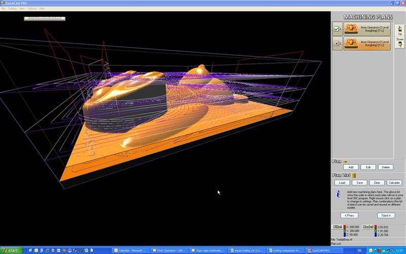

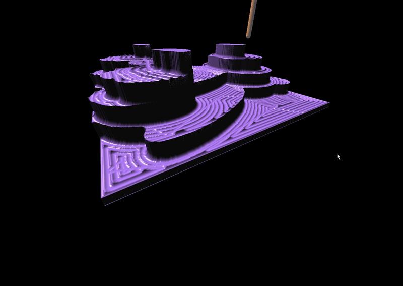

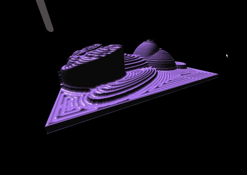

Re: What Value To Use For Tooth Load?
If you set the stepdown to 12mm the cut will not exceed 12mm in one pass.
If you select addaptive stepdown then the cutter will create multiple passes if the sides are slopeing
See the samples below.
Note if you are carrying out a finishing pass then the software assumes that the model has already been roughed out and goes to full depth from the start.
So if you had roughed the model as shown below with addaptive stepdown off the roughing takes much less time but in places the finishing pass could be removing 12mm of material.
with addaptive stepdown on the finishing pass would be much lighter.
