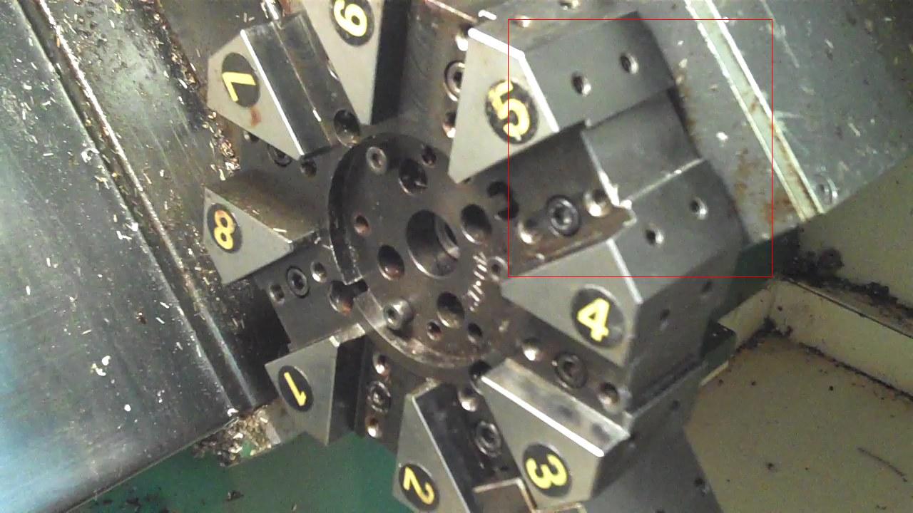

Hi.
Yes the turret is a Baruffaldi. Dims for the rectangular blocks used to hold sleeves for drilling/boring etc.
Re: Cyclone Tool Turret Drill Holder
Picture attached. Dims for the blocks attached to face plate.
that face plate has all the tool clamps missing as well as the drill blocks. Except tool position 3 which has a drill block fitted, possibly.
