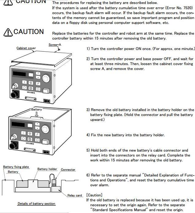

Is it necessary that if I change batteries of robotic arm in shoulder then I must have to change battery of controller?
I don't know exact model of battery in controller and also don't know how to replace controllers battery.
Model Of Batteries in Shoulder I bought is Er14250.
I read in manual how to replace battery in Shoulder but I cannot find how to change battery of Controller.
Kindly Let me know how to replace the battery in Controller.
Re: Robotic arm RV 2AJ S12 Issue
RV-2AJ -CR1-571 Controller battery replacement.JPG (86.62 KiB) Viewed 67077 times

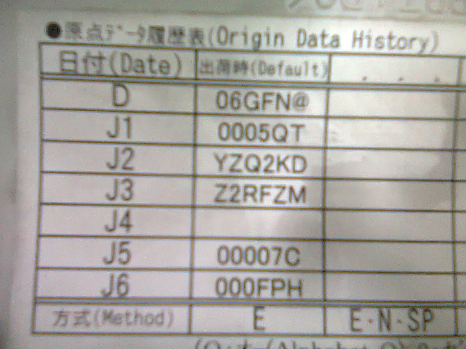

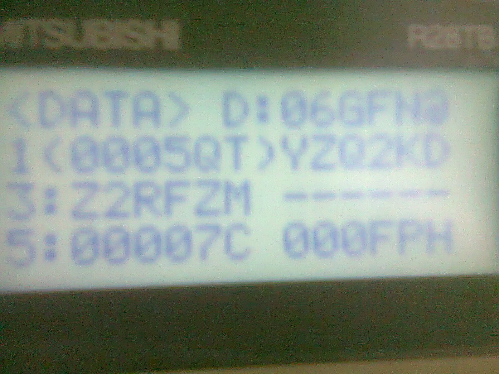

I found the origin data sheet....
I put them in maint-->origin--> data..
but it gave me same problem...
now J1 is working fine but J2 and J3 is not working
as far as Jig is concerned I observed that Third option in Maint-->origin--> which should be Jig is showing me -->tool
so Instead of maint--> origin-->jig
its showing Maint--origin- tool

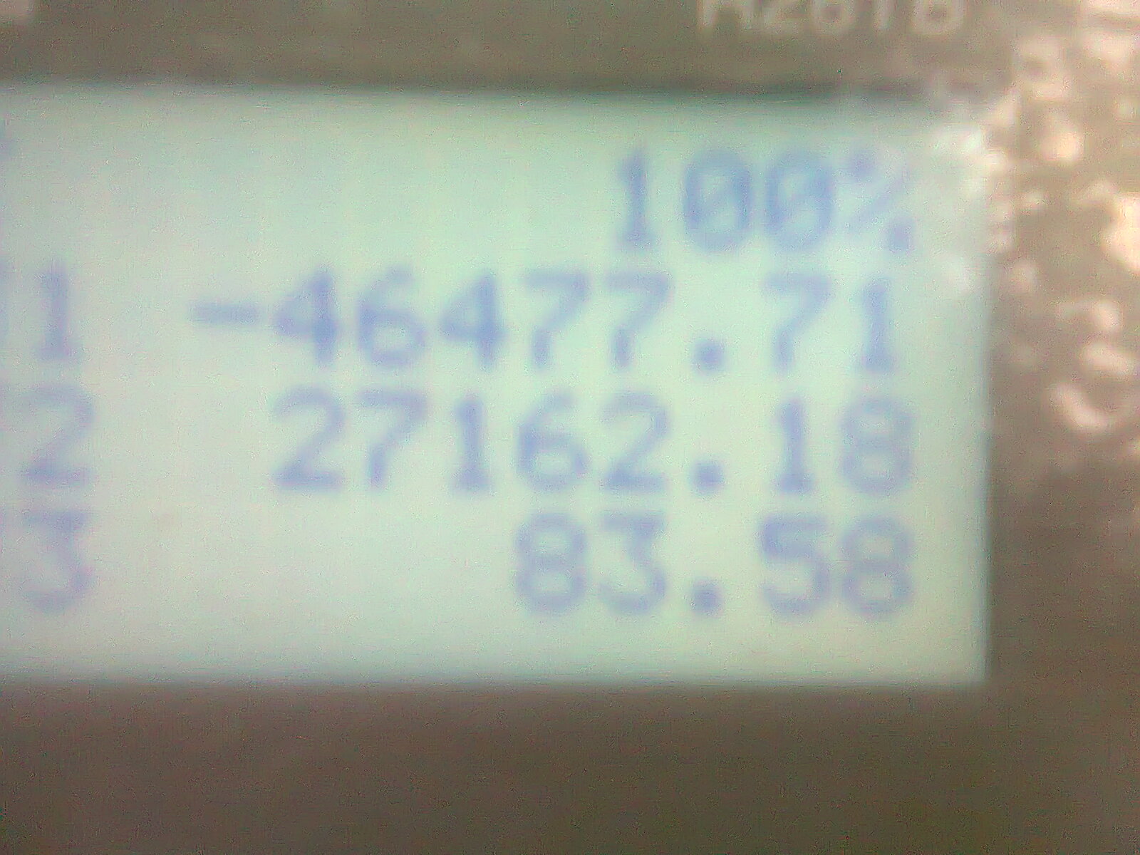

Figures attached....
Joint values
Joint values
Position of robot currently stucked
Values I entered
Values I entered
Values at back of cover
